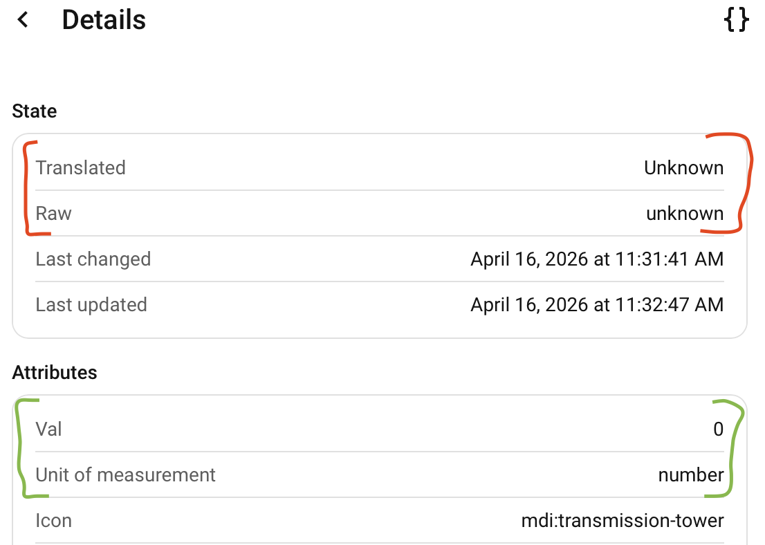

I’m working on a restful sensor to pull outage data from my energy provider, but I’m getting stuck on the value template. I know what the error means… it doesn’t like the “?”, but I can’t figure out format a valid JSON search in a value template to get the correct value. The output of the JSON attributes from the JSON attributes path is correct.
What an I missing to get the value template to have the same data as the JSON attribute? Is this a syntax issue?

Templates in HA use Jinja, so you need to use Jinja filters and functions, not a JSON query.
  - resource_template: "https://kubra.io/{{state_attr('sensor.austin_energy_url_generation_data','interval_generation_data')}}/public/reports/7e91b271-8db9-4931-a14c-67845dfcd496_report.json"
    sensor:
      - name: Austin Energy 78725 Affected
        unique_id: austin_energy_78725_affected
        icon: mdi:transmission-tower
        unit_of_measurement: "number"
        value_template: >
          {{ ((value_json.file_data.areas | selectattr('name', 'eq', '78725')|first).cust_a.val) }}
Thank you, that is exactly what I was missing. On my simpler restful sensors the json_attributes_path and value_template were basically the same and I was not putting it together that there were actually not the same query language.
