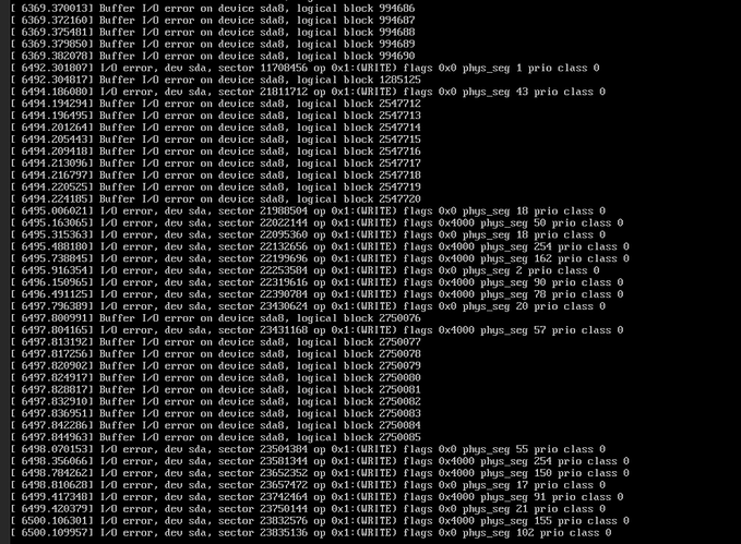

If I am using the backup from the RPI to restore this on the Proxmox HA VM, if I started the restore of my Backup I see in the Logs io read error, see attachment.
If you see i/o errors on your Proxmox vm, you would better reinstall it. These are errors that point to defects on the disk the VM is installed on.
everytime if i start the restore of my backup I got these error
Of cause. You want to restore a backup to a VM with a faulty disk. First job is to have a good running VM, then you can do a restore.
the VM is running normally, I can setup the home assistant in the VM but if I start the restore I got these error. Is it possible the reason why I got errors is that I used an external drive on my raspberry pi and not the sd card ?

@francisp I tried two ways, first way upload Backup for restore on VM → IO error
I mount my backup network drive into the new Home assistant(VM instance) started backup → IOERROR
Make a new HA VM and try on that. You current HA VM has problems with the disk.
You keep thinking the problem is with your backup file, it is not. The problem is with your HA VM.
Maybe to less space in the VM it works now
