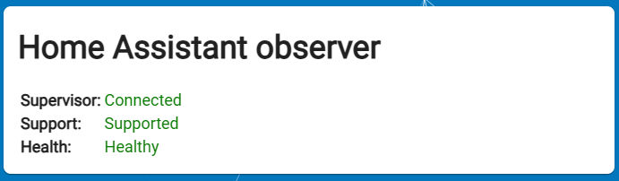

It works !
After restoring only addon to my new AH instance, i ran the addon “Advanced SSH & Web Terminal”, logged in SSH, restored my config, went to ssh and did
ah supervisor repair
ah core check
ah core start
and now i have it running… What a day.
