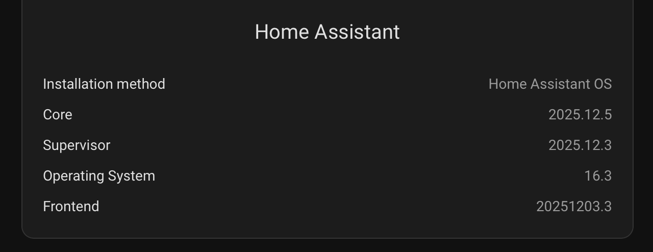

I’ve read on some forums that restores can take… 10+ hours. this was last year though. so im wondering if there has been any changes. Currently using the latest versions…

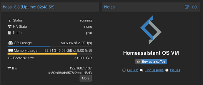

Is there any way to inspect the progress of this. CPU usage is 70% suggesting that it is doing something.

How do you know the CPU is at 70%, BTW?
It’s a proxmox VM running on a 32Gb RAM, SDD HDD, 3GHz system. I/O is not the problem. Proxmox can show me the stats.
