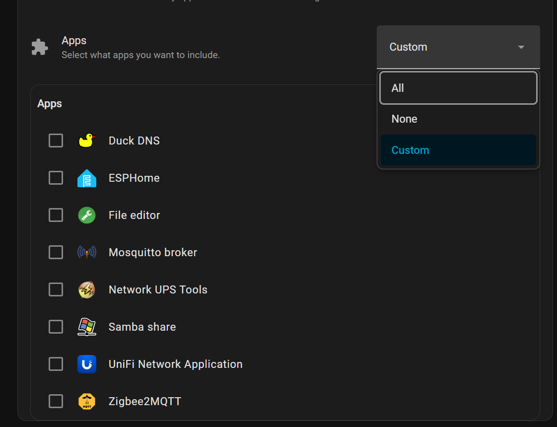

Maybe you didn't select them to be included in your backup (default is None).
All I know is that you can pick & choose which Apps are backed up for both the automated & manual backups

No one's stopping you from doing exactly that. You can leave your automatic daily backups to be backed up daily without apps.
Then, create a separate automation so that every month you'll have a full backup, including all apps.
If you want to be more granular, you can use hassio.backup_partial instead of hassio.backup_full - that will allow you to select which apps you want backed up. Far from the "all or nothing approach" you're making it out to be.
