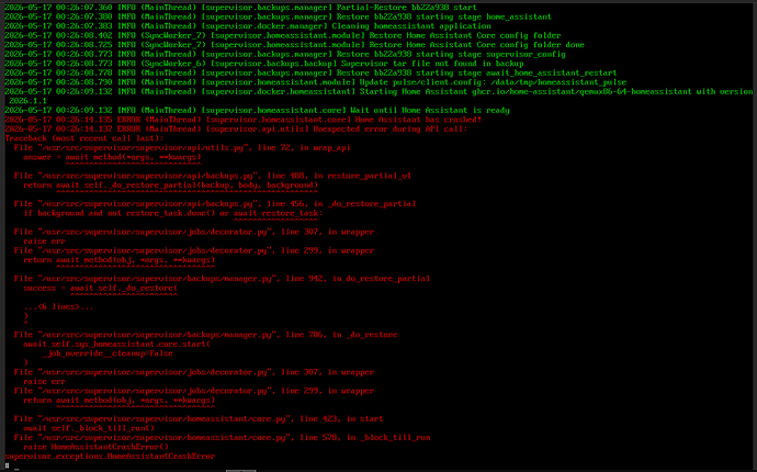

I try to restore the backup via CLI and the home assistant crashes:
If I try to do "ha core rebuild" it also crashes with a similar error.
