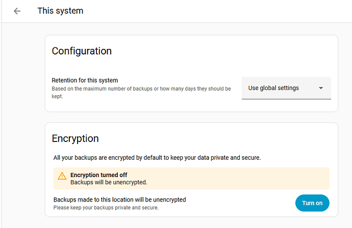

Yes I have been a silly boy - I wanted to get an old automation that I must have deleted and looked back in my backups and found the nearest date was last December (2024) so took a full backup today and restored the old December backup. Success there, I found and copied the automation code - great so far.
Went to restore the backup I took today and as you will all be aware (apart from me apparently) it is asking for an encryption code, I don’t have one!
The December restore is telling me that everything is out of date including Home Assistant Core so I updated to the latest (2025.10.1) which when you try to set up backups gives you an encryption key, I saved this one but it doesn’t work on the 2025 backups……
Can anyone help a silly boy……
Unfortunately you’re out of luck unless you can find the key (as in find somewhere you wrote it down or copied it) that was created when you originally setup your backups.
