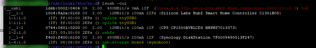

You're right--but I think I've gotten past that using instructions from Marius and some other resources. I did it once after upgrading to DSM 7 some years ago, and now I'm having to do it again after a (probably ill-opted) DSM upgrade to 7.3. I haven't had to do it again until now. This should be evidence that I'm past that point:

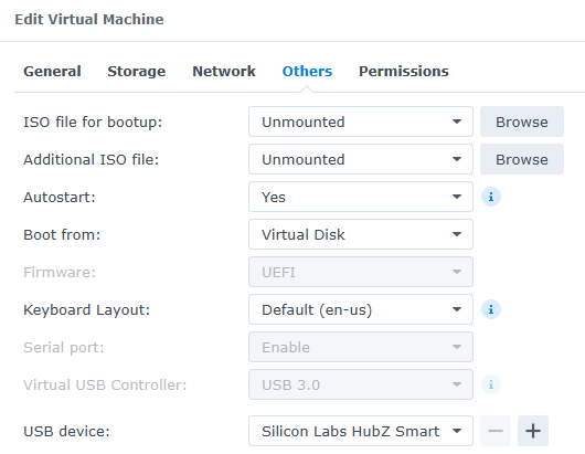

This is SSH into the Synology. Here's the VMM config in Synology:
This is how I've had it configured for many years. I've done a VMM restart to make sure it takes (and doesn't lose the config). The hardware screen in HA doesn't show ttyUSB0 or ttyUSB1.

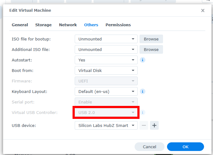

I'm pleased to be able to say... NO! I found the problem:
This was it. After shutting down the VM, setting this to USB 2.0, then restarting... everything came back. I could be imagining things, but I think I recall doing this last time. Maybe I should write this down. Or, bookmark this post.
