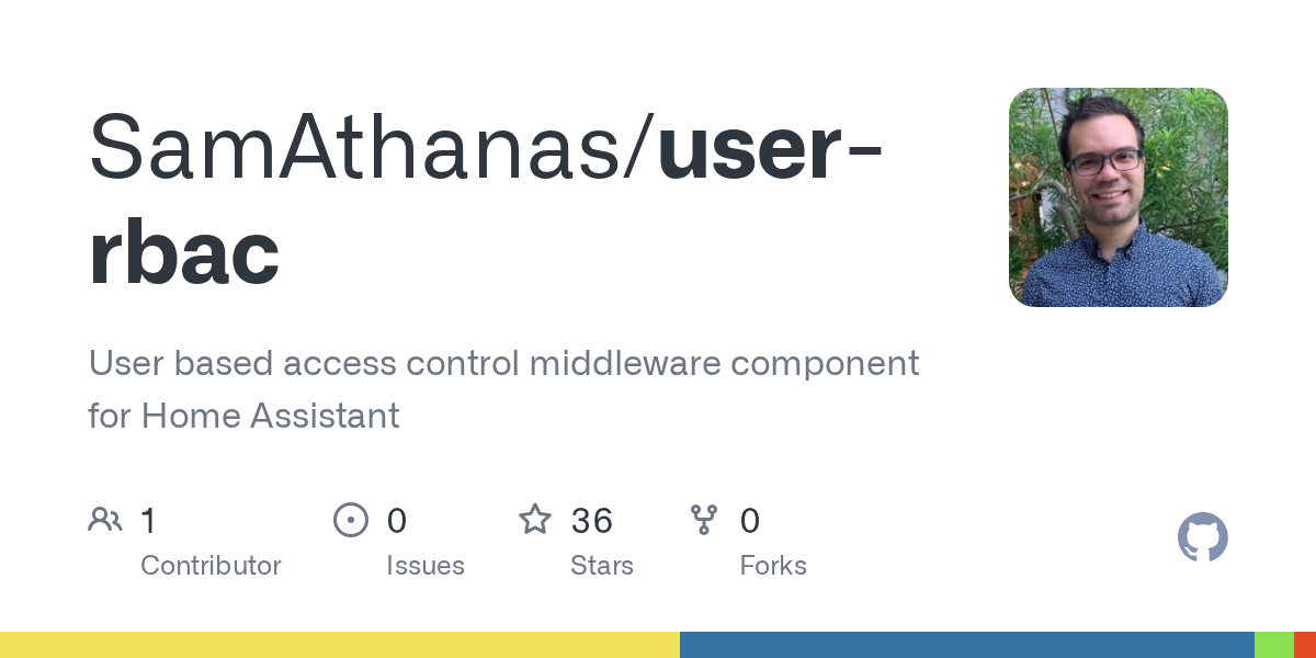

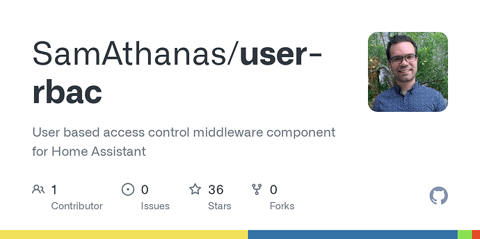

Pretty much. There is a new integration that enables RBAC (role based access control). It’s brand new and I have not used it. It should be able to allow you to deny access to the calendar.
