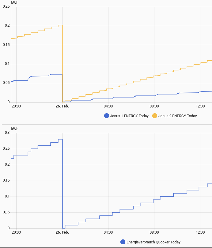

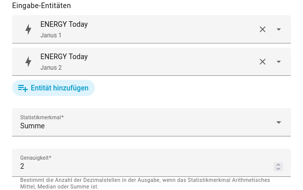

I have created a helper to sum up two entities:
If works perfectly and the sum is correct. What suprises me, that it is not shown alongside with the operands, albeit it has the same unit:
both are of unit kWh. Why are they not shown in the same graph.
Furthermore, in the statistics card, the sum sensor is not shown at all.
Can anyone explain this behavior to me?
Thanks!

Unless something has changed recently, the product of a Min/Max (aka “Combine the state of several sensors” Helper) does not have an assigned state class which is required for inclusion in LTS. You can add the necessary attributes through Manual Customization of the entity.
