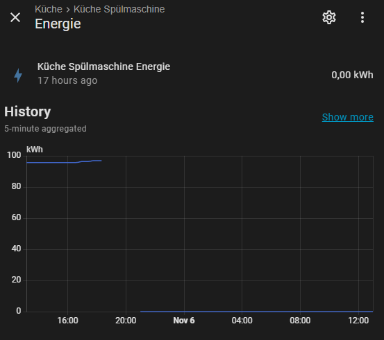

i’ve read that the actual Home Assistant version 2025.10 retains the history data (short term an long term) of the entity, if I delete the old device an rename the enitity of the new device to the old one.
This somehow has worked. When opening the history graph I see the old value, but then the value is set to 0.

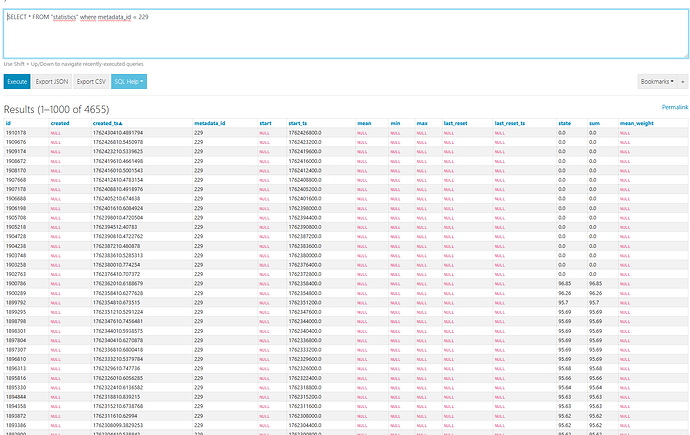

Whe looking at the statistics table I get this picture:
So the last value 96.85 stops beeing reported/increased and instead 0 is populated. Probably the value of the new plug. So something went wrong here I guess. Maybe somebody evaluate what.

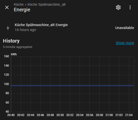

The old device shows the following energy graph (which is correct/the last state).
I thought HA might aggregate the data after a while but this has not happend yet (17 hours later). A reboot also didn’t help.

Just not right from the energy entity (history as you see in the screenshot is shown, but the enitity value itself is set to 0,00 for some reason).
