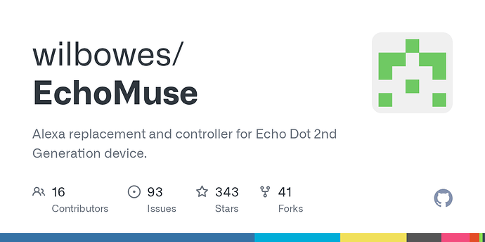

watch out! GitHub - aslater3/LibreEcho · GitHub

So for people with the 2nd gen Echo Dot. Somebody did it and manged to reflash the Echo Dot 2
Big respect, by far the most elegant way.
And most recently the echo Input, I hope to see EchoMuse support this device too!

So I managed to port Echo Muse to my Show 5 1st gen so just a matter of time until Echo Muse works with all devices with the Mediatek MT8163
Nice work! Did you happen to put this in a git repo? I could use it :sweat_smile:
