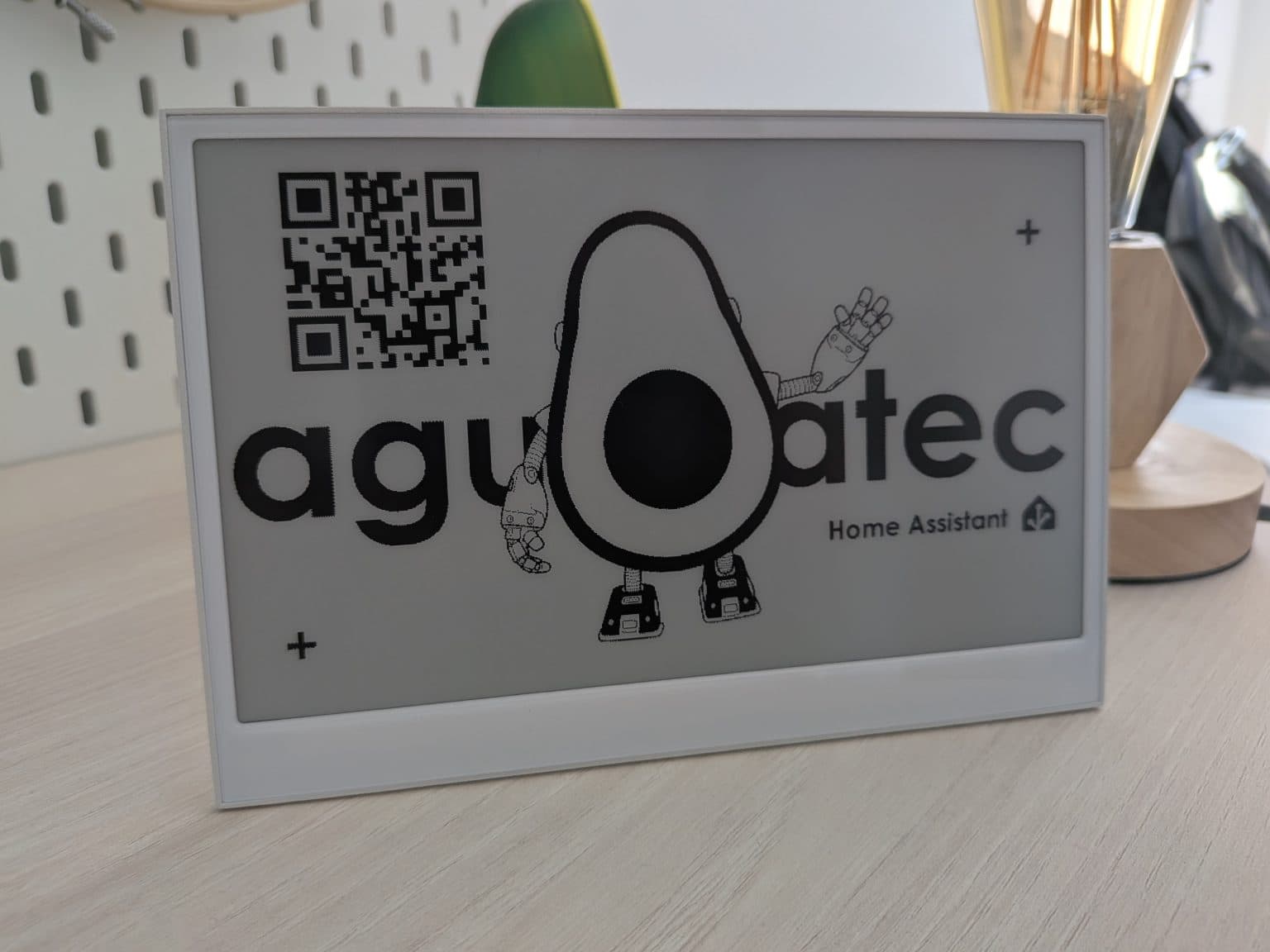

I got the new reTerminal E1001 from Seeed Studio, a cool ePaper display (probably the best i’ve tried so far).
It includes temperature and humidity sensor, battery and buttons. All of them can be monitored easily through HA, via ESPHome.
You can find full code and some examples in this article:
I hope you like it :slight_smile:

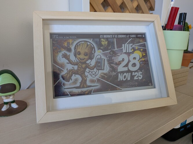

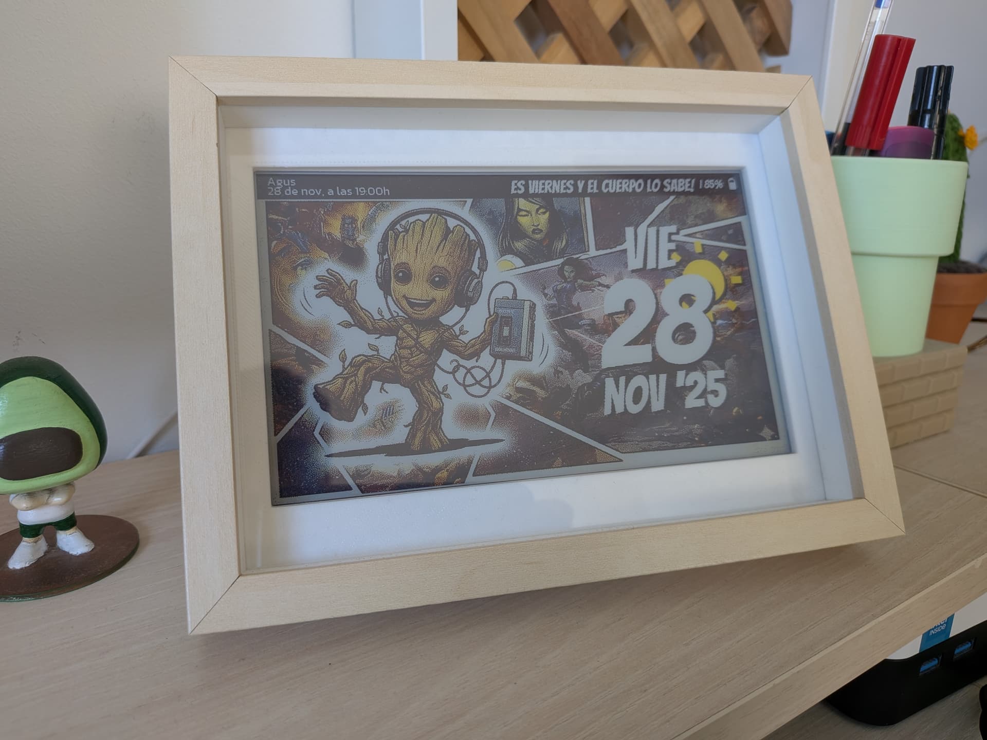

Thanks for the info! Currently i am playing with the E1002 (full color version), i will share the code soon!
I have designed a frame with my 3D printer so that the screen (both the reterminal E1001 and E1002) fits perfectly into the Ikea Rodalm frame. You can download it from this link (and, by the way, see a small spoiler of the ‘comic dashboard’ I created with the E1002 :sweat_smile:).
I just got an E1002. So far managed to get a photo onto it via SenseCraft, but haven’t been able to get ESPHome to connect/write to it. The E1002 seems to do a LOT of flashing/rendering to get the colors all working, which is kind of annoying. We’ll see how it goes once I get more details set up.
It is done via esphome or “screenshot integration”?
It does! It is supposed to need more time to load the image because of the colors, but it wasn’t enough for me to use full color images, until i found a workaround :grin:
100% ESPHome, I’ll share my code and technic soon!

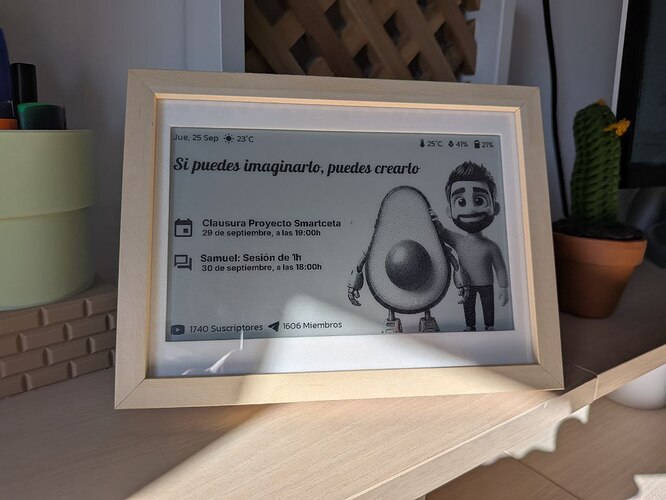

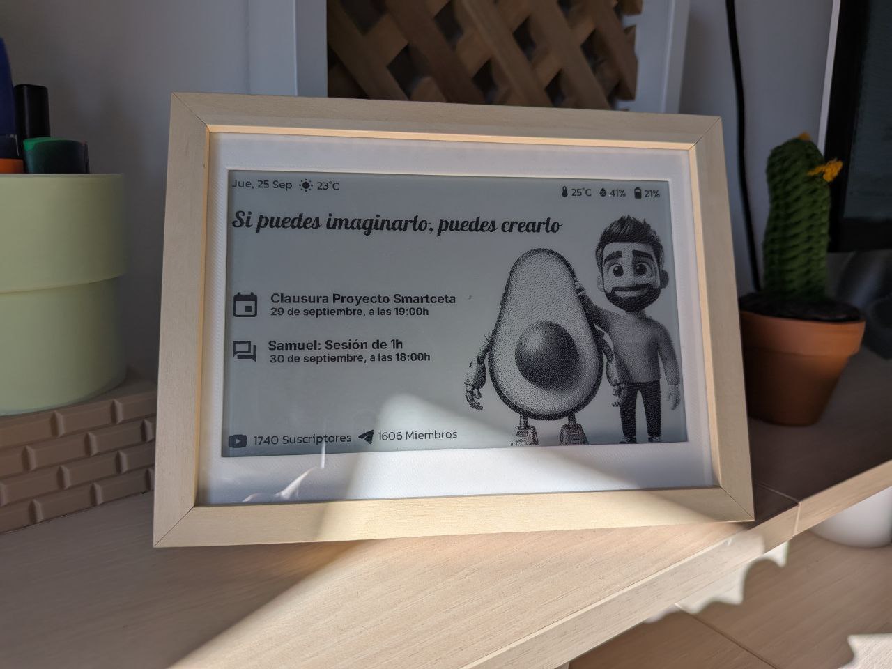

I made this work thanks to the article :wink:
I am very happy with this simple setup:
