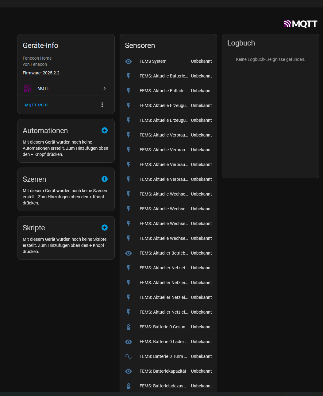

Hey, I have the problem that FEMS is no longer sending me any data. I have installed HA from a micro SD card to an SSD. Do I have to set anything else?
Log:
2025-03-15 11:20:33,516 - on_disconnect-MqttClient - paho-mqtt-client-Fenecon2Hassio_mqttClient_0 - WARNING - Unexpected MQTT disconnection code=Unspecified error. Will auto-reconnect in 5 seconds.
Seems like there is an issue with your MQTT Broker. Is MQTT working with other devices?
