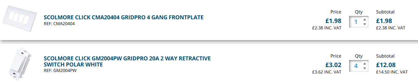

I’ve just found the Scolmore Grid Pro range to be a pretty good price range.
Have a look at LAP or Varilight or MK, you should be able to get a single switch setup for near £10
Will have a look at those, thank you.
Brief look at the Scolmore Grid Pro’s came out at…

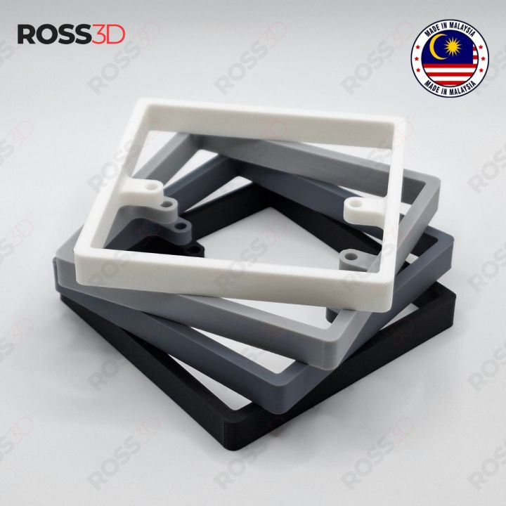

You can still get some spacers to fit the relay and add spring to existing switches to make them retractive
I have all my modules at the light fitting, this way there is a neutral available. For pendants I use these to give me more room:
