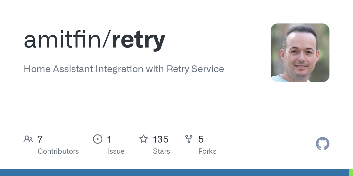

It HA is aware of it’s actual state (ie still on having failed to turn off) there’s a custom integration which might help:

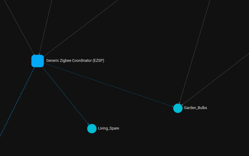

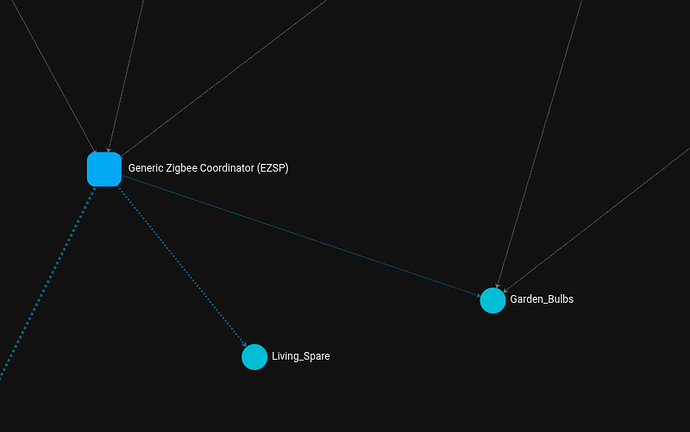

I’m facing an interesting network issue: the external network communicates well with the internal network under normal conditions. However, when the “door” (representing a physical or environmental factor) remains open for an extended period, the network starts routing traffic through this new path.
Once the door closes, that route becomes unavailable, but the network doesn’t immediately revert to the original, more stable route (through the “window” through the Living_Spare). Instead, it takes several hours to recover and re-establish the previous connection.
I’m hoping to resolve this by installing a strong repeater to reinforce the preferred route and ensure more consistent connectivity.

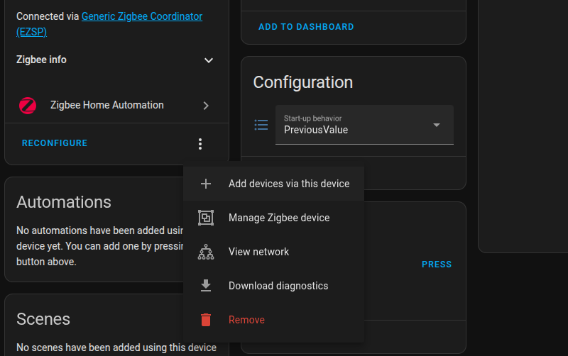

Is there a way to enforce that the Garden_Bulbs ‘router’ consistently uses the Living_Spare as its primary connection path?
I have tried this option ( Add devices via this device ), but after add the Bulb it will not connected through the Living_Spare, but add shows above.
“Network Routing Challenge: Seeking Stability”
Zigbee builds its own mesh, you can’t force it to choose certain routes. You can add a Zigbee dongle flashed with router software ( as they usually attract more routes), but no guarantees.

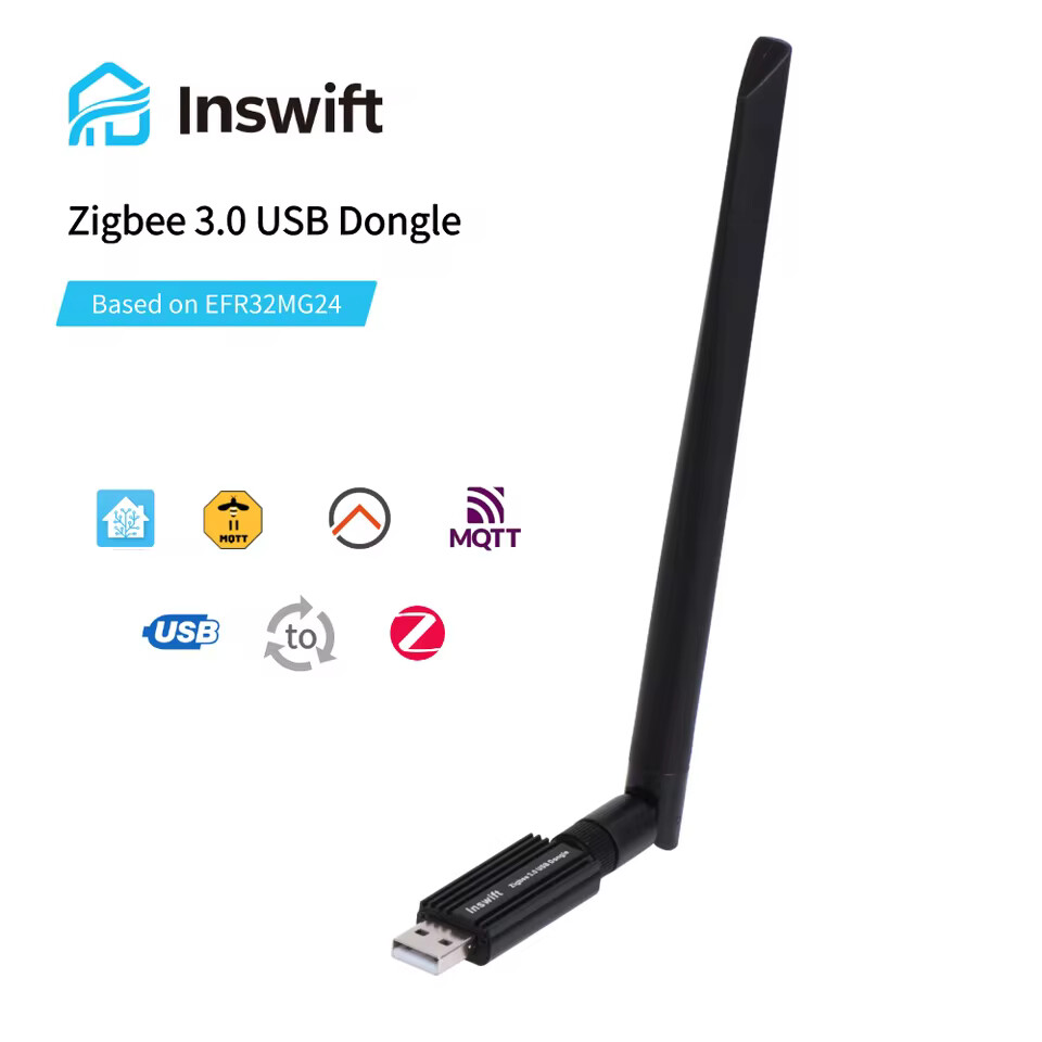

Something like this: Inswift Zigbee3.0 Dongle USB Gateway Universele ZigBee Gateway met antenne Compatibel met Home Assistant OpenHAB ZigBee2MQTT
And than flash the repeater firmware?
Should work.
Then just look for another repeater :frowning:
We are very sorry. Since our product has no buttons, it will automatically connect to the network when powered on after the router firmware is burned. If the network - connection fails, the firmware needs to be burned again, which is quite troublesome. Therefore, we do not recommend selling this product to users.

According to the seller, this one should also work: the Inswift ZBM-MG24 Zigbee 3.0 USB dongle (EFR32MG23). Slightly cheaper than the “Sonoff Dongle-P.”
If you don’t advise against it, I’ll order it. :+1:

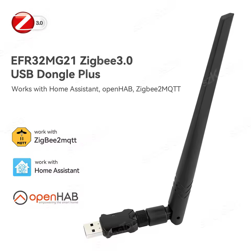

If the specs are to be believed, I have this dongle in my Raspberry Pi: EFR32MG21 (CH9102F, +20dBm). It works perfectly.
