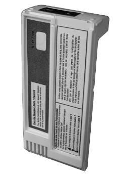

Lots of heaters are supported, but they need to use this particular type of RF cassettes:
