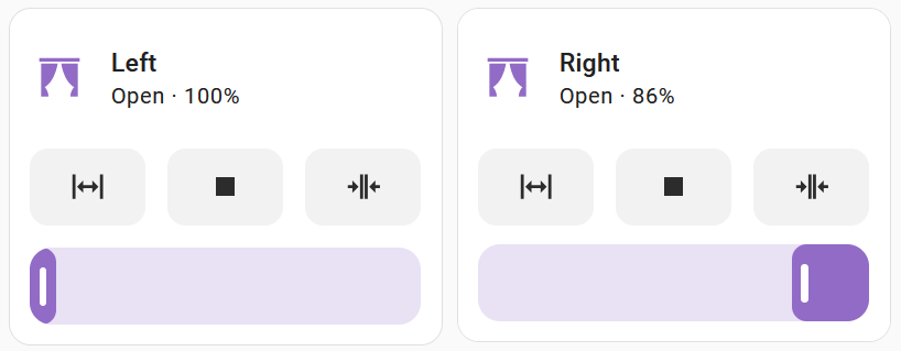

Came across this thread when looking for a way to implement the same myself.
After some tinkering I came up with the following:

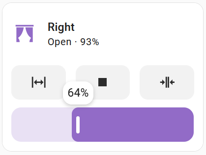

Interacting with the slider also shows the tooltip correctly:
Here’s the YAML for the right curtain card:
type: custom:vertical-stack-in-card
cards:
  - features:
      - type: cover-open-close
    type: tile
    entity: cover.livingroom_curtain_rear_right
    features_position: bottom
    vertical: false
    card_mod:
      style: |
        ha-card {
          --tile-color: var(--state-cover-active-color) !important;
        .content {
          /* Needed for the name and state to line up with the Left card */
          padding-top: 20.45px !important;
          padding-bottom: 20.45px !important;
  - type: tile
    entity: cover.livingroom_curtain_rear_right_inverted
    vertical: true
    features:
      - type: cover-position
    card_mod:
      style:
          .vertical {
            display: none !important;
        hui-card-features$ hui-card-feature$ hui-cover-position-card-feature$ ha-control-slider$: |
          .container {
            --value-rtl: calc(1.0 - var(--value));
          .slider .slider-track-bar {
            left: unset !important;
            right: 0px !important;
            transform: translate3d( calc((var(--value-rtl, 0) - 1) * var(--slider-size) * -1), 0, 0 ) !important;
            border-radius: 8px !important;
          .slider .slider-track-bar::after {
            left: var(--handle-margin) !important;
            right: unset !important;
Note that this does require you have an inverted template for the right side curtain. E.g. something like this:
cover:
  - platform: template
    covers:
      livingroom_curtain_rear_right_inverted:
        unique_id: livingroom_curtain_rear_right_inverted_template_cover_
        position_template: "{{ 100 - (state_attr('cover.livingroom_curtain_rear_right', 'current_position')|float(0)) }}"
        set_cover_position:
          - service: cover.set_cover_position
            data_template:
              entity_id: cover.livingroom_curtain_rear_right
              position: "{{ 100 - position }}"
This workaround is cumbersome and not ideal. We’d definitely be better off with a simple config option for slider features that would allow us to reverse the direction. But for the time being this works for me :slightly_smiling_face:.
