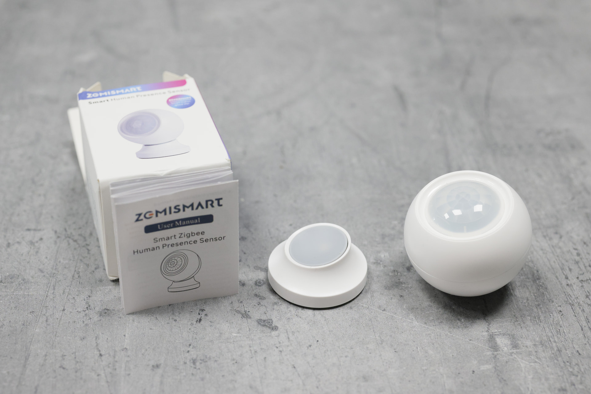

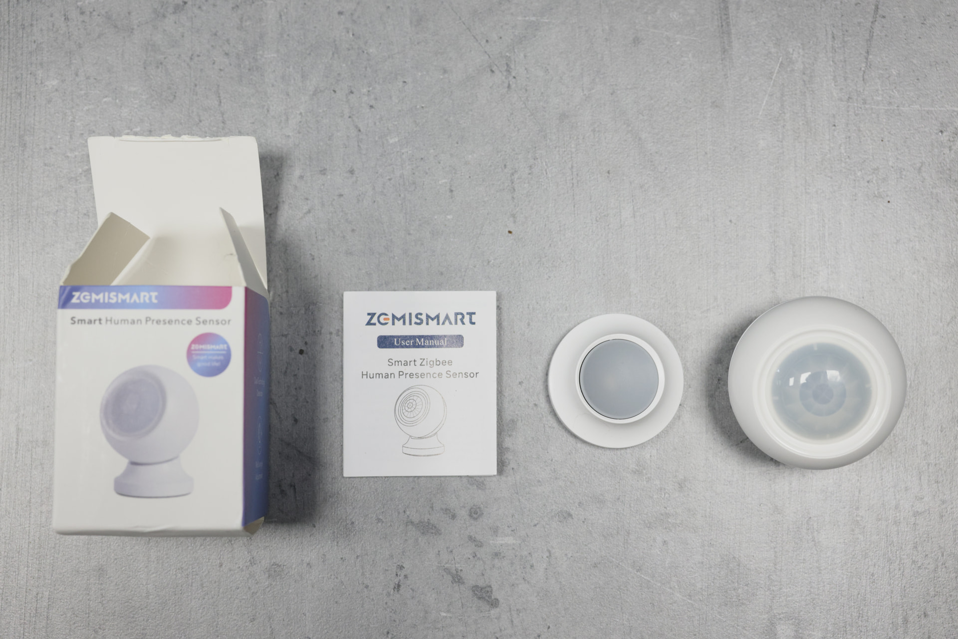

The Zemismart ZPS-Z1 comes in a compact box with everything you need to get started:
  • Sensor itself
  • Magnetic mounting stand
  • User manual

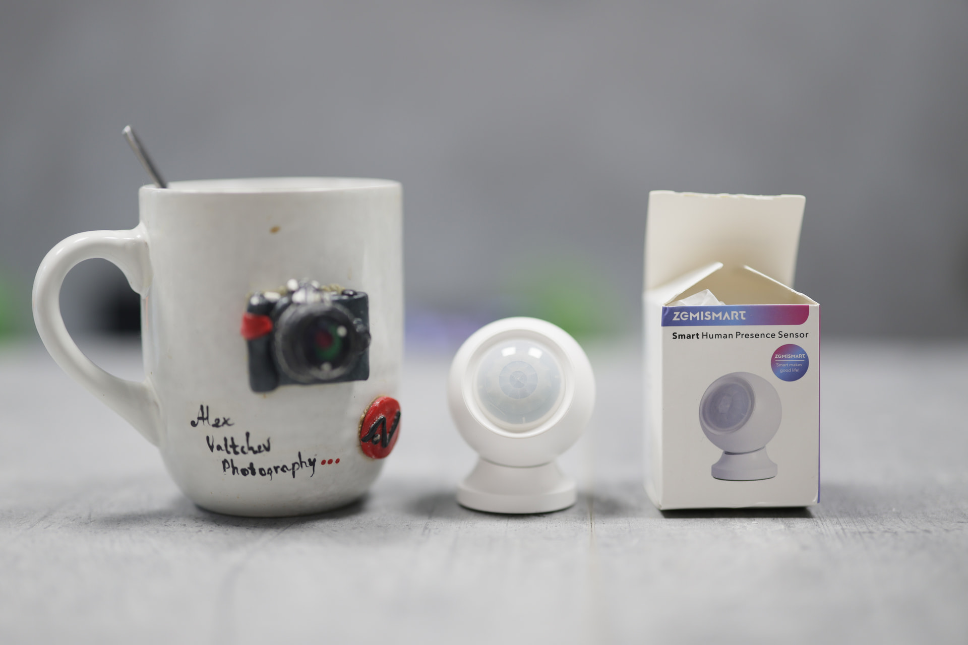

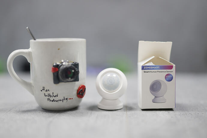

The sensor measures 48.9mm in diameter, which I think is a good balance. It is not tiny, but it is also small enough to blend nicely into most rooms. With the magnetic stand attached, the total height becomes approximately 63mm.
The magnetic stand is actually very well designed. It snaps into place firmly and can be moved anywhere across the entire back of the sensor. There is no fixed mounting position, which gives you a lot of flexibility depending on where you want to install it.
Zemismart also includes a pre-applied 3M adhesive pad on the bottom of the stand, so installation is quick and easy.

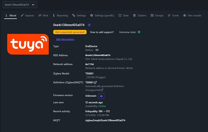

Zigbee2MQTT Setup

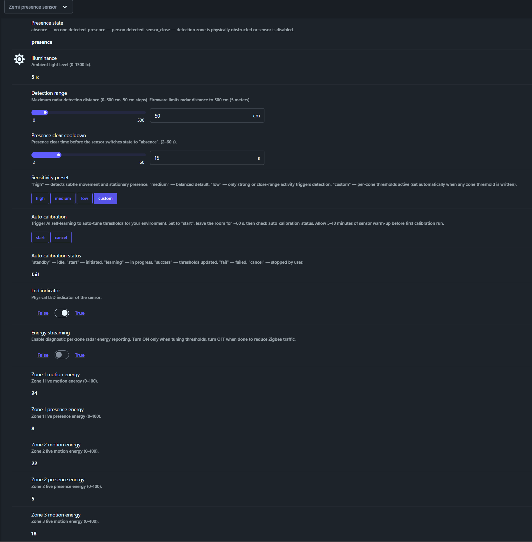

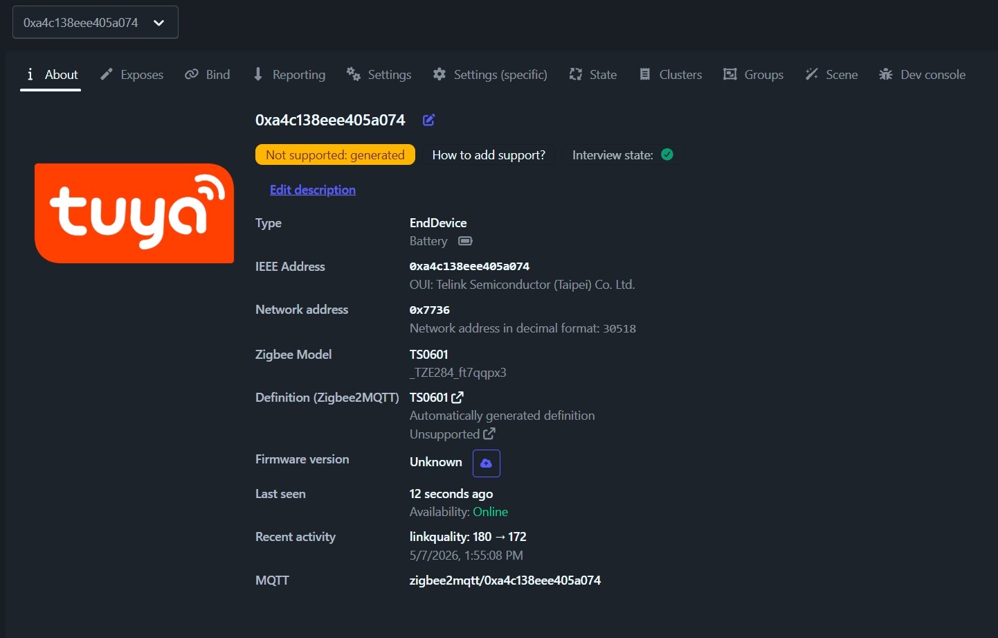

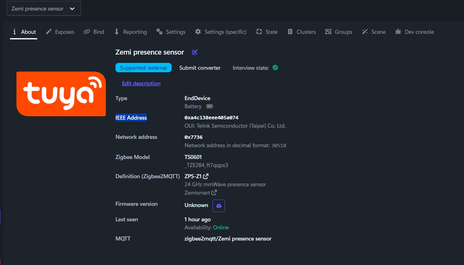

Pairing the sensor through Zigbee2MQTT was very easy, and after adding the external converter this is what it exposes:
The Zemismart ZPS-Z1 identifies itself as:
  • Model: TS0601
  • Manufacturer: _TZE284_ft7qqpx3
When I started this review about 2 months ago, the device was not fully supported. After installing the external converter, everything worked properly.

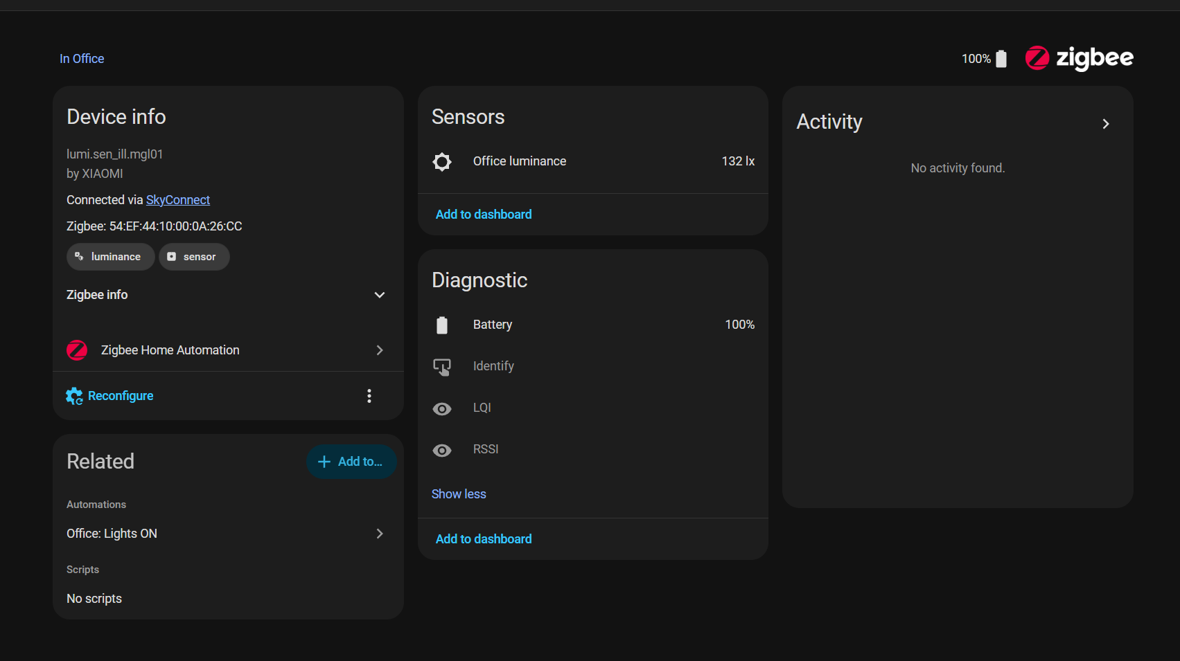

Illuminance Sensor
Ambient light level: 0-1300 lx
For my use case, this did not perform very well.
At first, I thought this function simply did not work. Later I noticed that the value does update, but it takes a very long time.
I waited around 3-4 minutes, and the value still had not changed.
For my automations, this is too slow.
I have been using and really like this Xiaomi luminance sensor, which updates much faster, usually within 2-3 seconds, and I can rely on it for lighting automations.

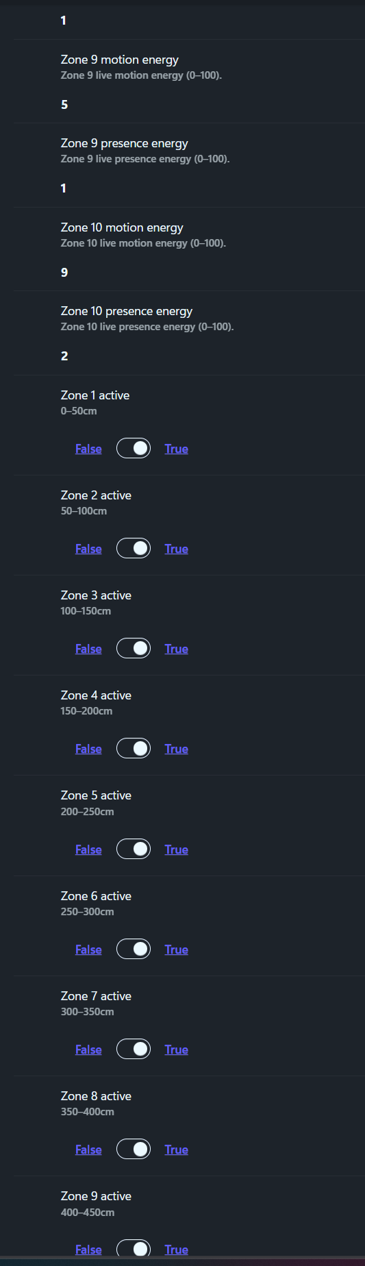

Testing and Tuning
When fine-tuning the sensor, first set the detection range to 500cm. After calibration is complete, lower it to your desired distance.
At first, auto calibration did not work for me.

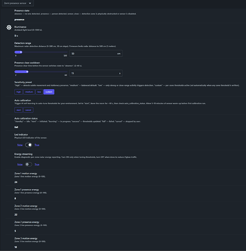

Then I changed:
  • Sensitivity preset → CUSTOM
  • Energy streaming → TRUE
The sensor showed “learning”, but calibration failed.
I tried again a second time, and this time it succeeded.
I am not exactly sure why it fails sometimes and works other times. That is something Zemismart would need to explain.
After successful calibration:
Energy streaming must be turned OFF (FALSE).
I then lowered my detection range back to 400cm, because my room is approximately 430cm long.
Using a laser distance meter, I noticed a small difference. Even with detection range set to 500cm, the closest detection distance was around 3.7m (370cm).
With the second test, detection range was set to 400cm, and the sensor detected me at 3.98m, which is basically perfect.

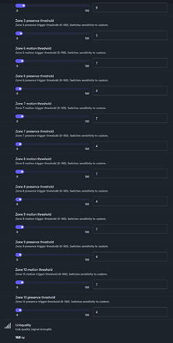

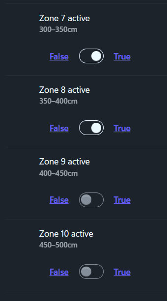

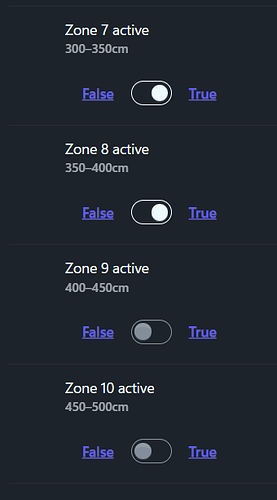

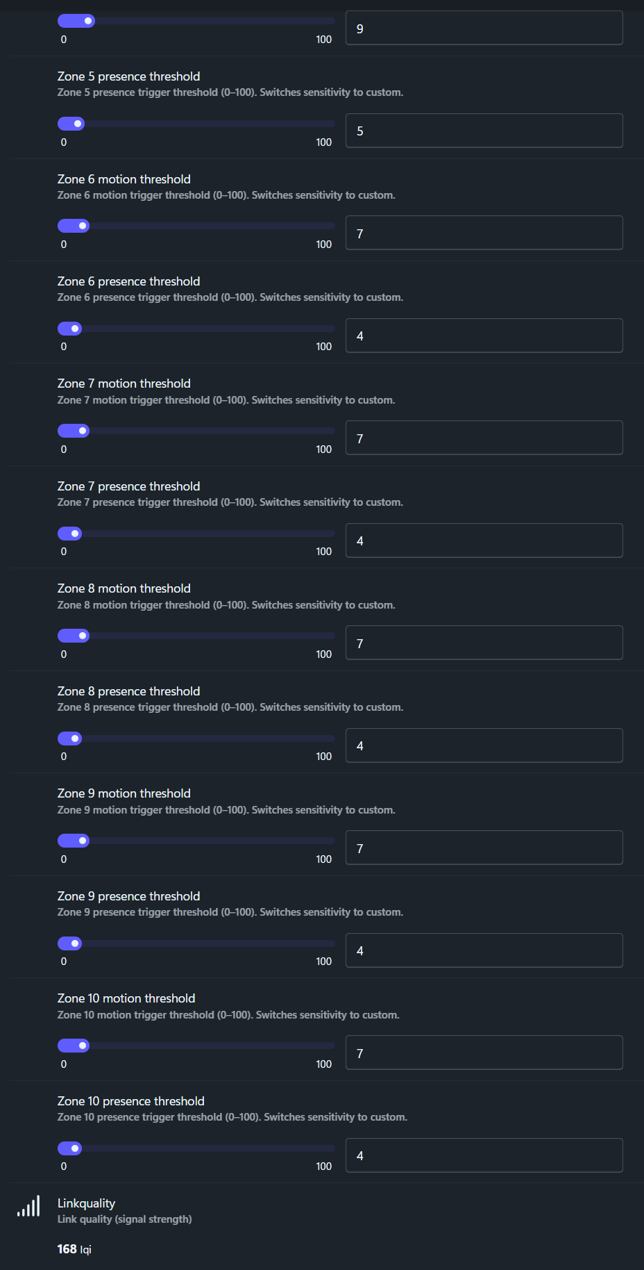

Zone Settings
Since I already set my detection range to 400cm (4m), I am still not completely sure what the individual zone settings add in my case.
In my logic, the detection range already covers this area, but maybe the zones work differently internally.
I left zones 9 and 10 OFF because they are beyond my needs. They cover areas beyond the 4m range, basically from the end of my room to the entrance.
After testing for several days, I found that each zone needed to be increased by around 30-40% in my case to trigger correctly and clear the presence state faster.
The presence clear cooldown was set to 15 seconds, but actual clearing time was usually around 30 seconds.
Simple Setup Recommendation
If you don’t want to spend hours tuning:
  1. Set detection range to 500cm
  2. Set presence clear cooldown to your desired value
  3. Set sensitivity preset to CUSTOM
  4. Enable auto calibration (Energy streaming ON)
  5. Wait until calibration succeeds
  6. Turn Energy streaming OFF
  7. Lower detection range to your desired distance (steps of 50cm)
If you are within 1.5-2m, LOW sensitivity should work.
HIGH sensitivity sometimes did not clear properly.
MEDIUM is probably the mode I would recommend if you don’t want to manually calibrate and tune everything.
