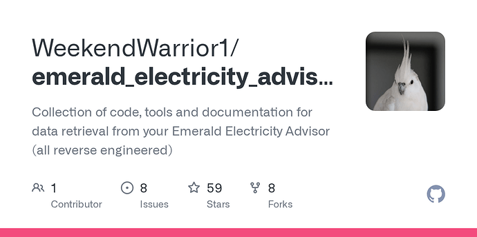

  • WeekendWarrior1 — for the original reverse-engineering work on the Emerald protocol and the ESP32/Arduino proof of concept this was built on top of.

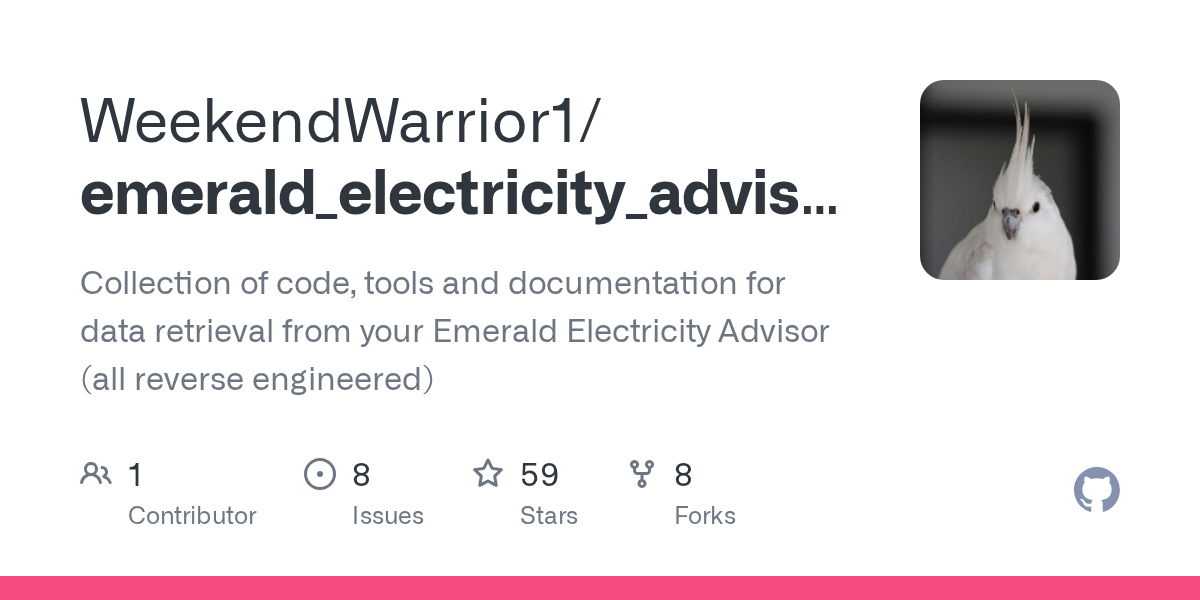

The equivalent code for the Emerald monitor is similar to the PowerPal code and you may find benefit to peruse both on GitHub with the extensive number of forks, as well as examine the extensive thread here in these forums.

The original reverse engineered Emerald code:

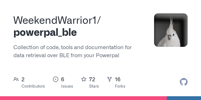

The original reverse engineered PowerPal code;
