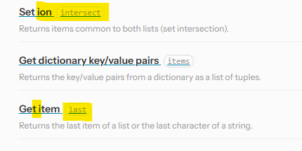

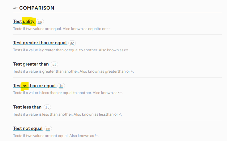

A few typo’s here:
Something funny going on there with the text getting truncated and shifted to the function name?

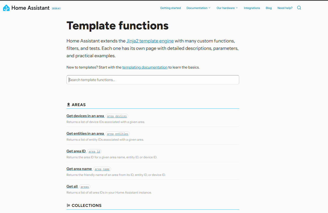

I also think this page might be a bit more digestible if either the categories were collapsed or if they were each presented at the top or in the sidebar so you can see all categories before you get searching.
Thanks! That one was reported on quite a few places. It is a technical error though, as those pages are generated.
I’ve opened up a pull request to fix that one here: Fix and DRY up template function category listing pages by frenck · Pull Request #44518 · home-assistant/home-assistant.io · GitHub
Thanks for reporting as well <3!

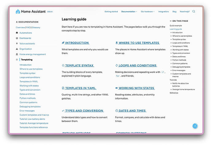

Landing page: none of the links on the right hand side work.

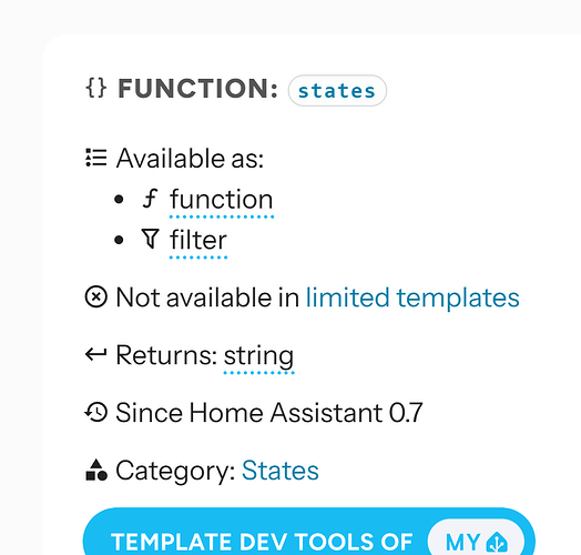

And the reason I was there in the first place… the states() function page seems to suggest that it can be used as a filter or a function…
Also there is only one parameter and there should be 3. This example even shows the unit of measurement being added after the template (hard coded) which seems all kinds of wrong to me considering that it’s otherwise accurately provided.
Fixing the broken TOC links in this PR: Exclude landing page card titles from 'On this page' TOC by frenck · Pull Request #44519 · home-assistant/home-assistant.io · GitHub
Will look at the other comments next.
…/Frenck

It can be:
Fix for the missing parameters are pending in a pull request here: Document missing rounded and with_unit parameters for states() by frenck · Pull Request #44520 · home-assistant/home-assistant.io · GitHub
As pointed out by @Didgeridrew, it actually can be used as a filter :slight_smile:

Right, thanks. I had not used it that way previously but my quick test was a bad implementation, I tried it on a generator object :man_facepalming:
