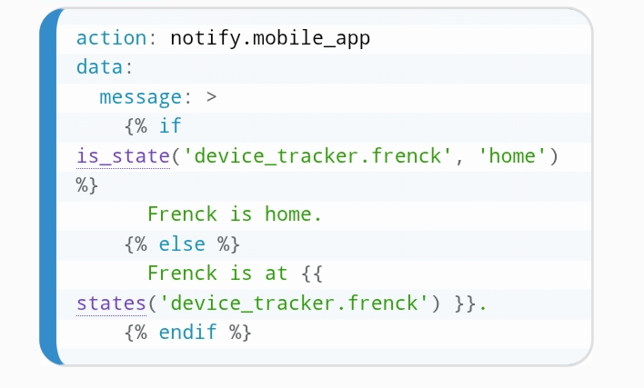

I just started reviewing the greatly improved Templating documentation and my first impression is that novices should not read it on a phone.
I imagined being a novice when I looked at the very first template example. Word-wrapping ruined the indentation and made it a confusing mess. It’s a good example but not when it gets truncated and rearranged by word-wrapping.
To be clear, it’s a pre-existing problem but it’s magnified now because the new documentation is rich with examples.
Perhaps some sort of advisory is needed such as “all examples are best viewed on a monitor to prevent word-wrapping” or something similar.

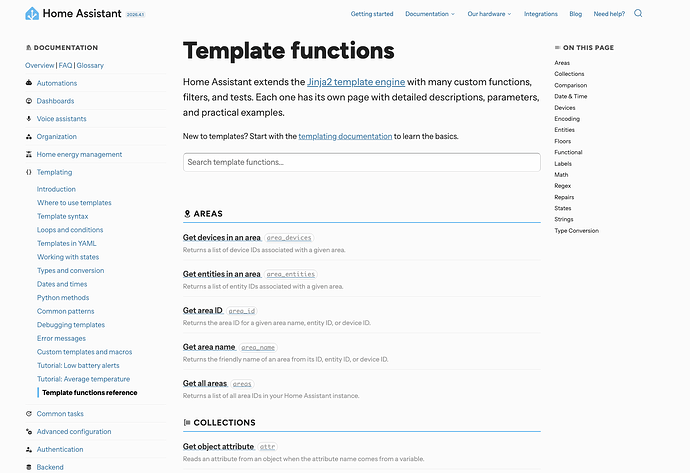

Does the left side menu only provide two levels?
If so, I wonder if the Template function reference should be its own top-level so that expanding that could show a condensed menu of functions. It’s just odd when you click on the function reference page and you lose context since there’s no menu.
TBH, I’d get use to this (I’d bookmark the reference page), but once you go through the tutorial-type pages one spends most of the time in the reference page. (Where the Error messages page would live is less clear.)

I don’t know about it’s own top level, but I could do this:

That is less disorienting. Thanks.

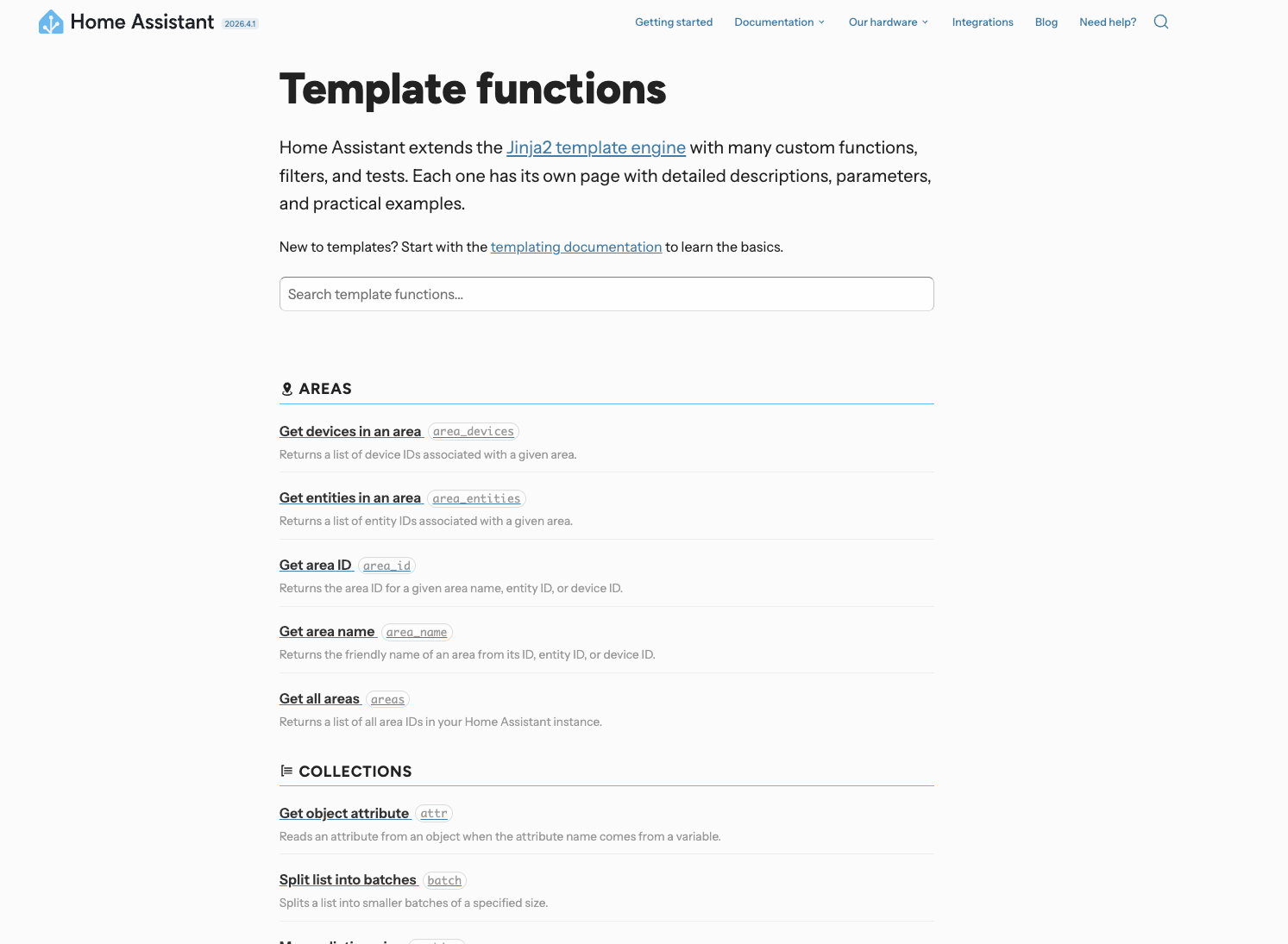

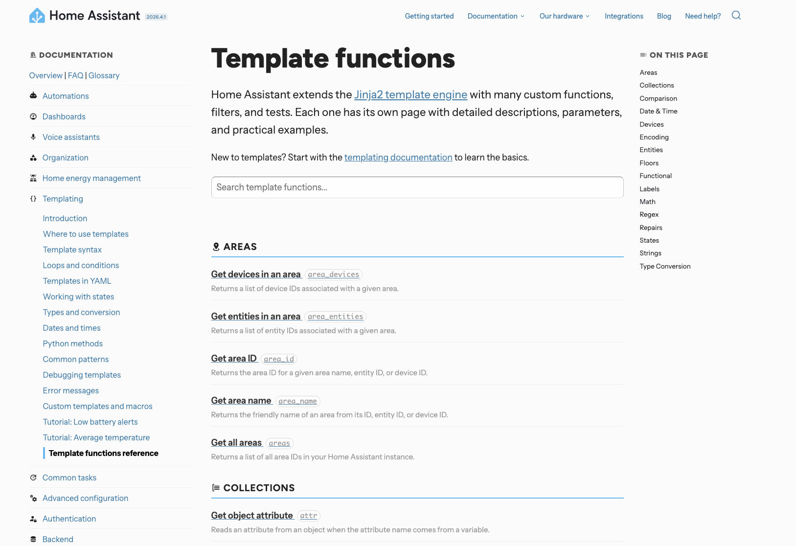

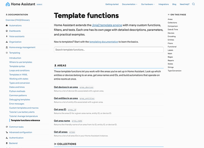

Made an PR to improve the navigation for the function reference index, as pointed out in multiple places.
Before:
After:

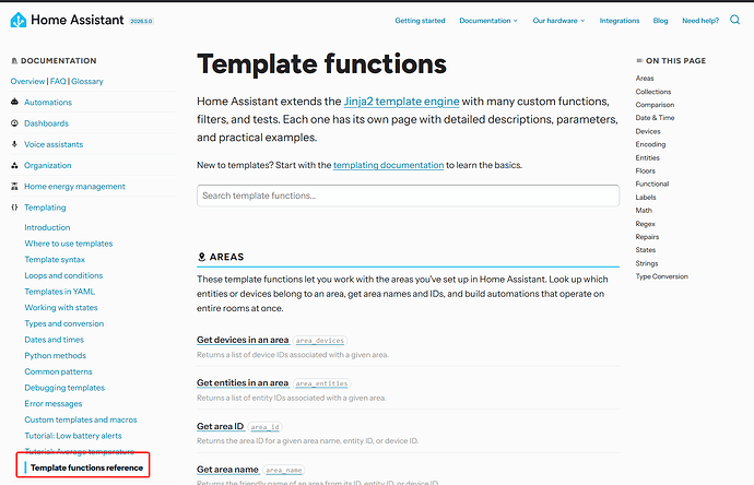

The main drawback of this sectioned layout is that it is no longer possible to easily search the whole page with a simple Ctrl + F. Before, you could find immediately what you needed by targeting a term on the flat page. Now you have to repeat the same search guessing which section might have what you’re looking for, or use the built-in search icon on the upper left, which gives you collapsed results your have to dig through.
For example, it took me more time and it was awkward to find out how to get an area name by id. I’d just have searched for “area“ and quickly go over each hit. This time I just quit and asked AI, which said to use the function area_name(). Then I went back to Templating and searched for that function using the magnifying glass, which took me to the beginning of Tutorial: Get notified when a device needs a new battery; I still had to do a Ctrl + F on the page to find area_name. A workflow reversed and convoluted compared to what the previous format allowed.
Click the template function reference page.
It would be good to have this link prominent near the top, perhaps in page TOC (On this page) under Reference. That @odwide needed to ask where this was says that a quick link like this is expected.
