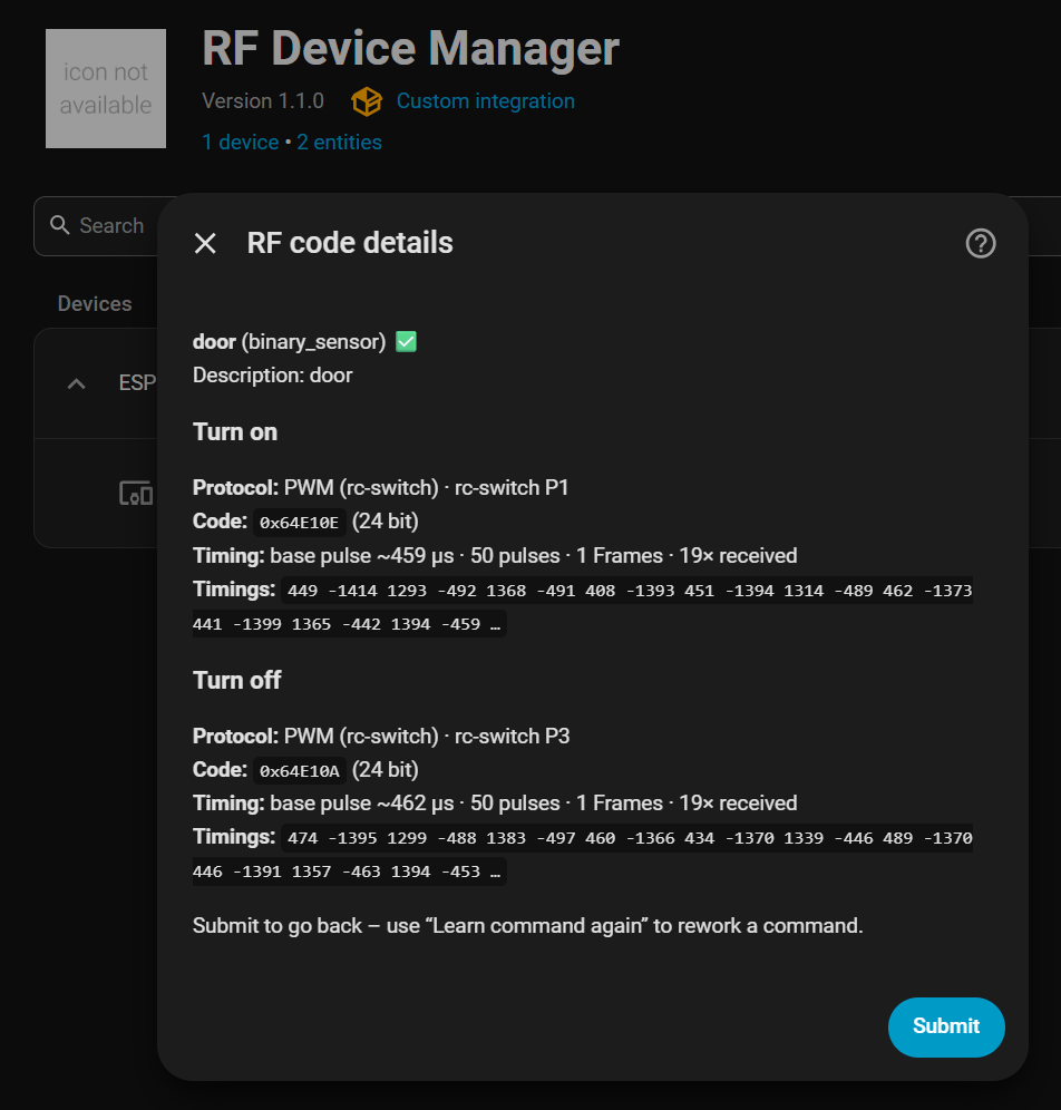

I have quite a number of Pir and Door sensors based on ev1527.
I’ve captured a door sensor that works and I can see it as open or closed.
The code for a door example is -
0x18290A for open and 0x18290E for closed.

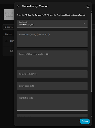

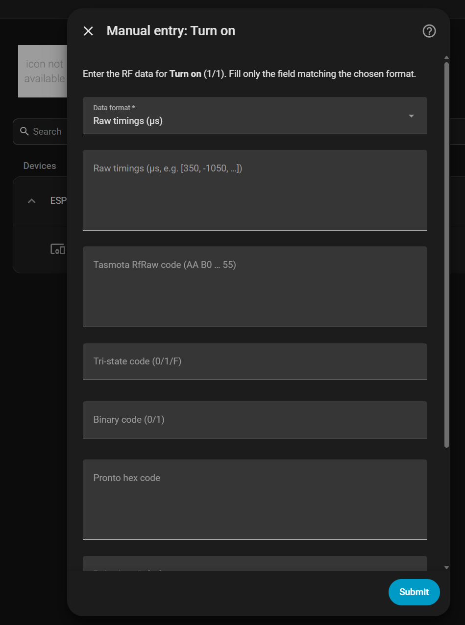

From my sonoff setup I have these codes for approx 15 other door sensors. Is it possible to type these codes in manually rather than having to go around learning each door sensor?
So far I have had no luck using the manual method.
Thanks for any assistance.
(A captured door sensor that works perfect)
Not sure if it is possible to just enter the code on this manual screen. Everything I tried did not work.
