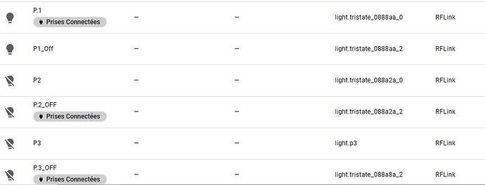

I try other form ;
light:
  - platform: rflink
    automatic_add: false
    devices:
      tristate_0888aa_0:
      tristate_0888aa_2:
      tristate_088a2a_0:
      tristate_088a2a_2:
      tristate_088a8a_0:
      tristate_088a8a_2:

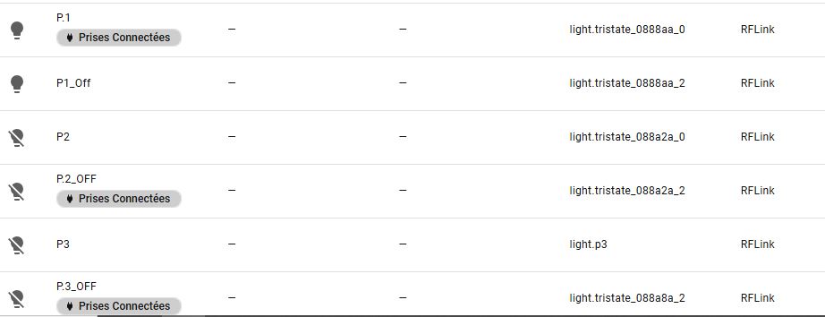

Here the result in device and service :
The device labels have reverted to the names of the automatically detected devices that I had deleted… I don’t understand!
Is there anything I need to delete from the old configuration?
