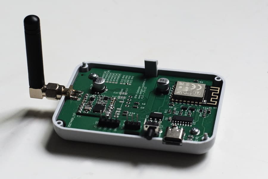

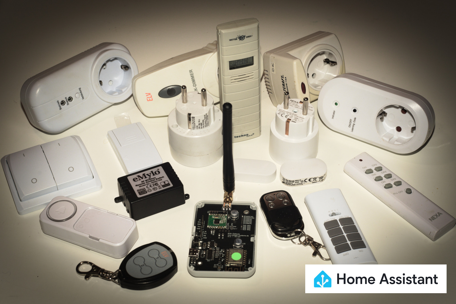

I would like to present my RFM-Gateway project.
Equipped with an ESP8266 CPU and a RFM69 radio module it is able to send and receive radio signals from and to several devices:
  • Intertechno, Telldus, Nexa switches & remote controls
  • ELV FS20 switches and remote controls
  • LaCrosse temperaturesensors (TX29, TX35, …)
  • Bresser 7in1 weather stations
  • Conrad energy count 3000

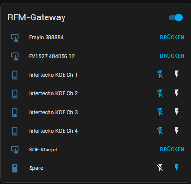

Firmware v2.6 is released:
It introduces a new tab on it’s webUI where commands to receivers can be sent and a switch can be added to Home Assistant with a single click:

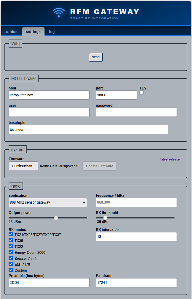

Firmware v2.9 released:
  • add custom RF parameters for 868 MHz mode
  • Show battery-low sensor in home assistant
  • eye candy
