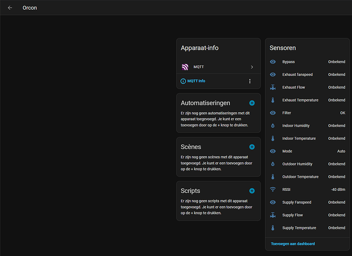

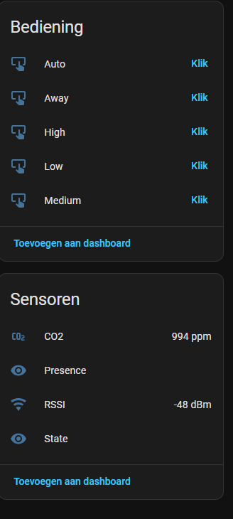

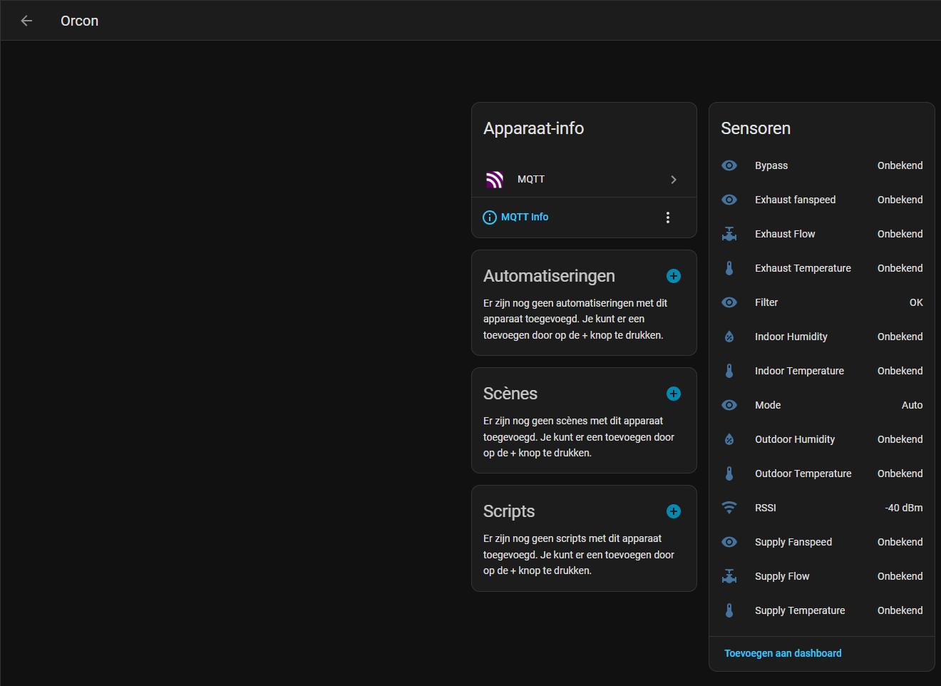

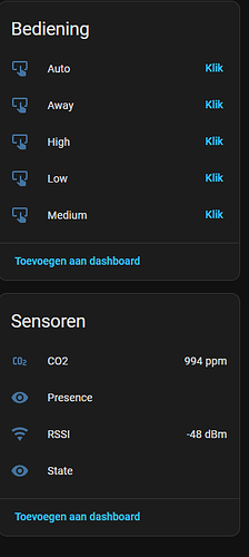

Hello, after having a lot of contact with the RFXCOM Support and figuring the problem out. i hope this information is helping someone.
I have a 15RF (CO2 Bedieningssensor inbouw 15RF - Orcon) and a Orcon MVS-15R
If your trying to use RFXCOM-868 you need to the following to make it work.
  1. Reset the 15RF remote
  2. Turn the Orcon MVS-15R off and turn it back on after 10 seconds
  3. Connect the 15RF Remote again to the Orcon MVS-15R
  4. Configure the RFX-868 to use MQTT/Wifi
  5. leave the Orcon ID empty and turn on Auto Discovery
  6. Press a button on the 15RF Remote and everything should be added
In my case i got 3 MQTT devices (Orcon/Orcon-868/orcon_randomid)
