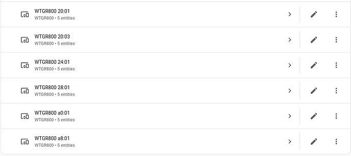

Just an additional question:
The device gets detected over and over…
it started of with 20:01, and there is already SIX instances. Anybody know why?
the initial instance seems te work fine. Just delete the others?
tx,
ps: although distance is only 15 meters, the device indicates it’s signal is at -80 dbm, maybe due to connection issues?
