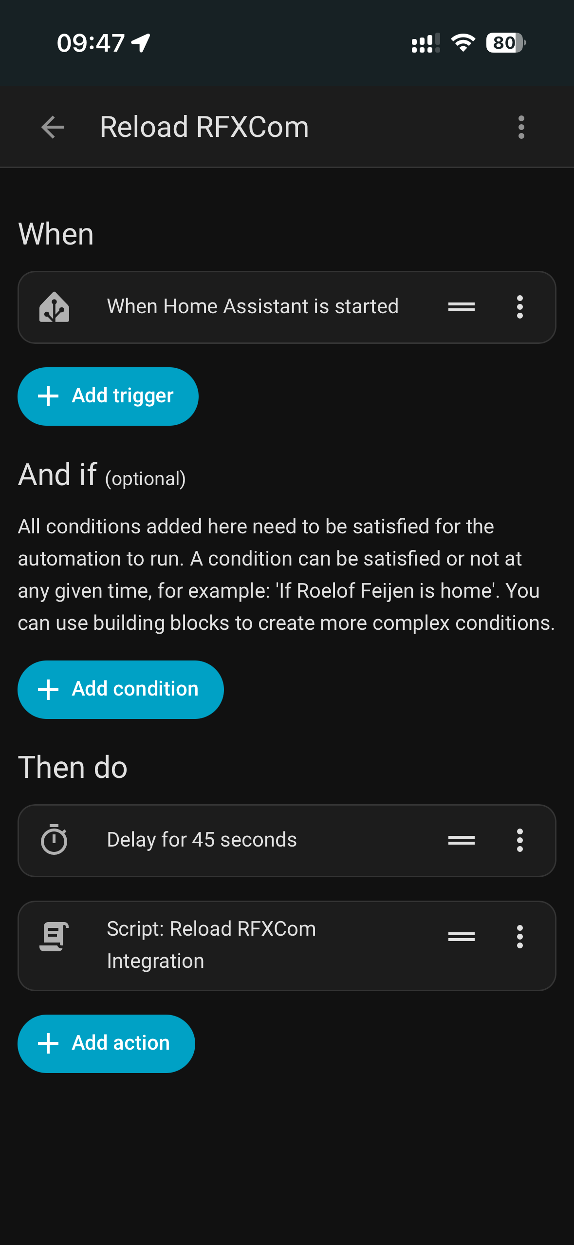

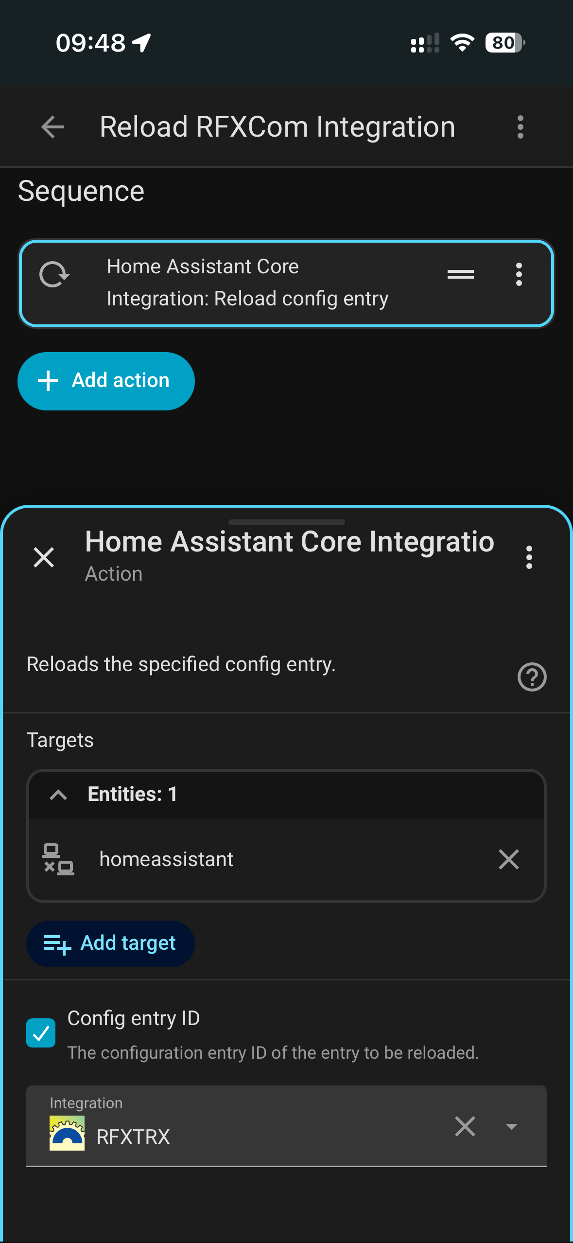

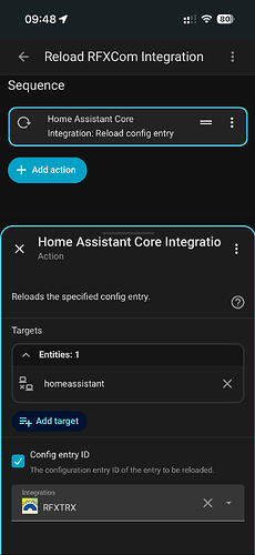

Because I restart my Docker image every day, I created a Script and an Automation. Go to Settings > Automation & Scenes and add a Script and Automation following the images below. It works like a charm.
It's here, but does not work after reboot...
@boudeweyn What did you enter at 'entity' in the script, I'm not able to find the same as you show in the image.
I did reload the RFXcom integration manually and that solved the issue. After a reboot the issue is back. A manual reload makes it available again.
I use the RFXcom for blinds with Brel motors.

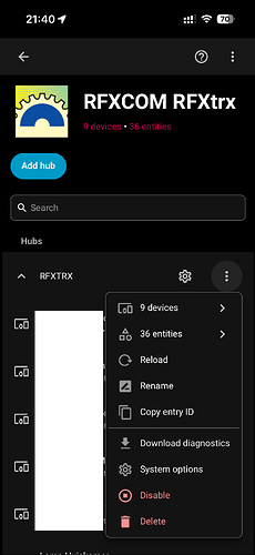

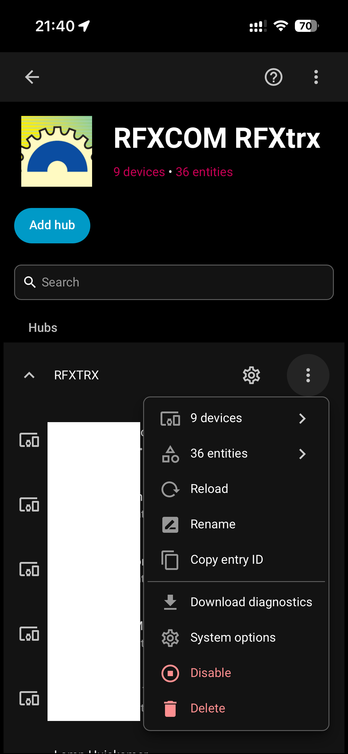

In Settings > Devices & Services > select the RFXCom integration. Then click on the 3 dots. Copy entry ID. Hope that helps.
i dont find the config entry id, can you give me the yamil of the automation , please
This is how mij yaml script looks like. But I have my doubts if my entry id is the same as yours:
homeassistant.reload_config_entry
metadata: {}
  entry_id: 6232a4a855da80975aa5f783d6f08218
  entity_id: device_tracker.homeassistant
and this is how my automation yaml looks like:
alias: Reload RFXCom
description: ""
triggers:
  - trigger: homeassistant
    event: start
conditions: []
actions:
  - delay:
      hours: 0
      minutes: 0
      seconds: 45
      milliseconds: 0
  - action: script.reload_rfxcom_integration
    metadata: {}
    data: {}
mode: single
