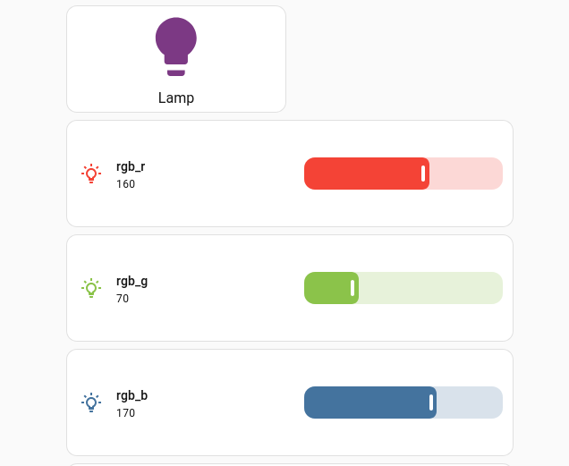

I first created 3 Input helpers called rgb_r, rgb_g and rgb_b

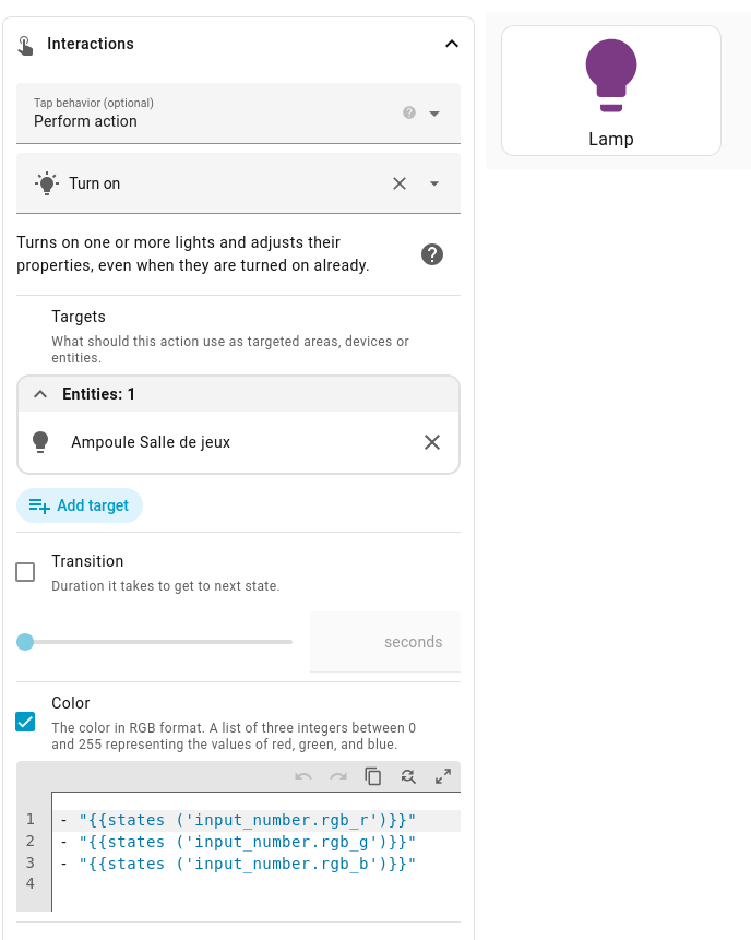

Then I created following dashoboard for the UI:
When I click the Lamp icon, it should Perform action Light_turn_on.
And lamp shoud glow according the settings of the three sliders
Instead, I get

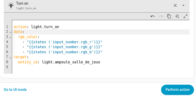

In developpers tools - Actions
It works fine when I click Perfom Action

Templates are not supported in UI Interactions.
The way you can do this is make a script with that turn on command, and then call that script from the action.
Templates are not supported by Home Assistant’s official set of Cards (the sole exception is the Markdown Card).
The standard workaround is to create a script containing your desired actions and templates. Then the Card’s “Tap behavior” is configured to call the script.
So what you tested in Developer Tools → Actions should be included in a script. Then for the Card’s “Perform Action”, set its target to the script.

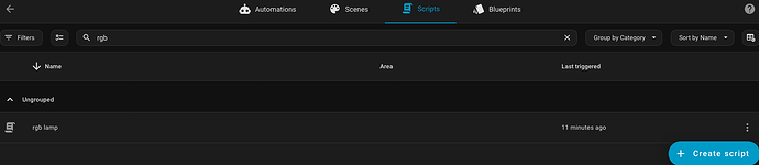

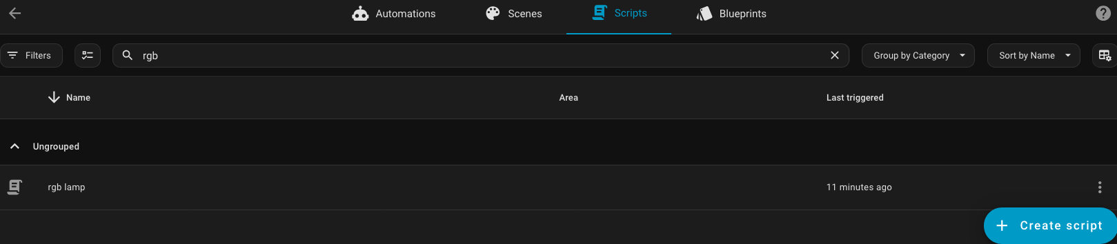

In settings - Automation & scenes I found scripts then clicked Create script
Then I create the script called rgb lamp in visual editor as follows:

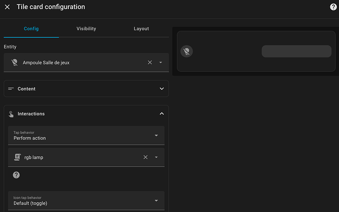

And finally in the UI Tile card configuration , added Interaction - Tap behaviour - Perform
and typed the script name (rgb lamp). I could have done do the same with a button
