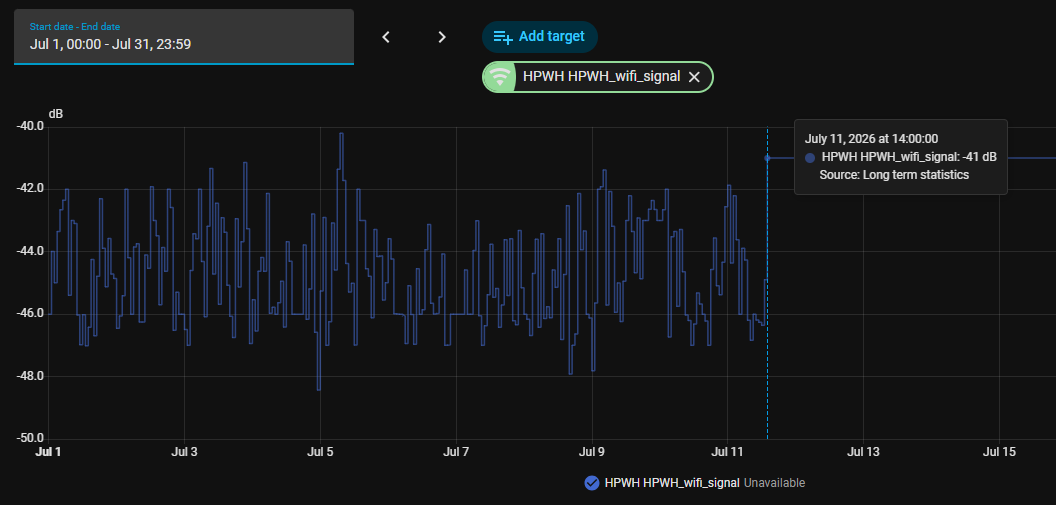

Looks like the integration stopped working on July 11th at around 2PM my time.
