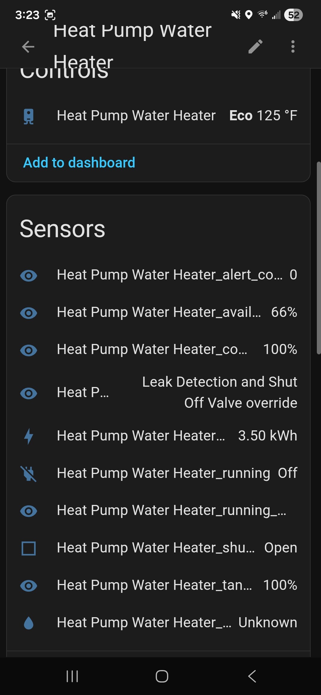

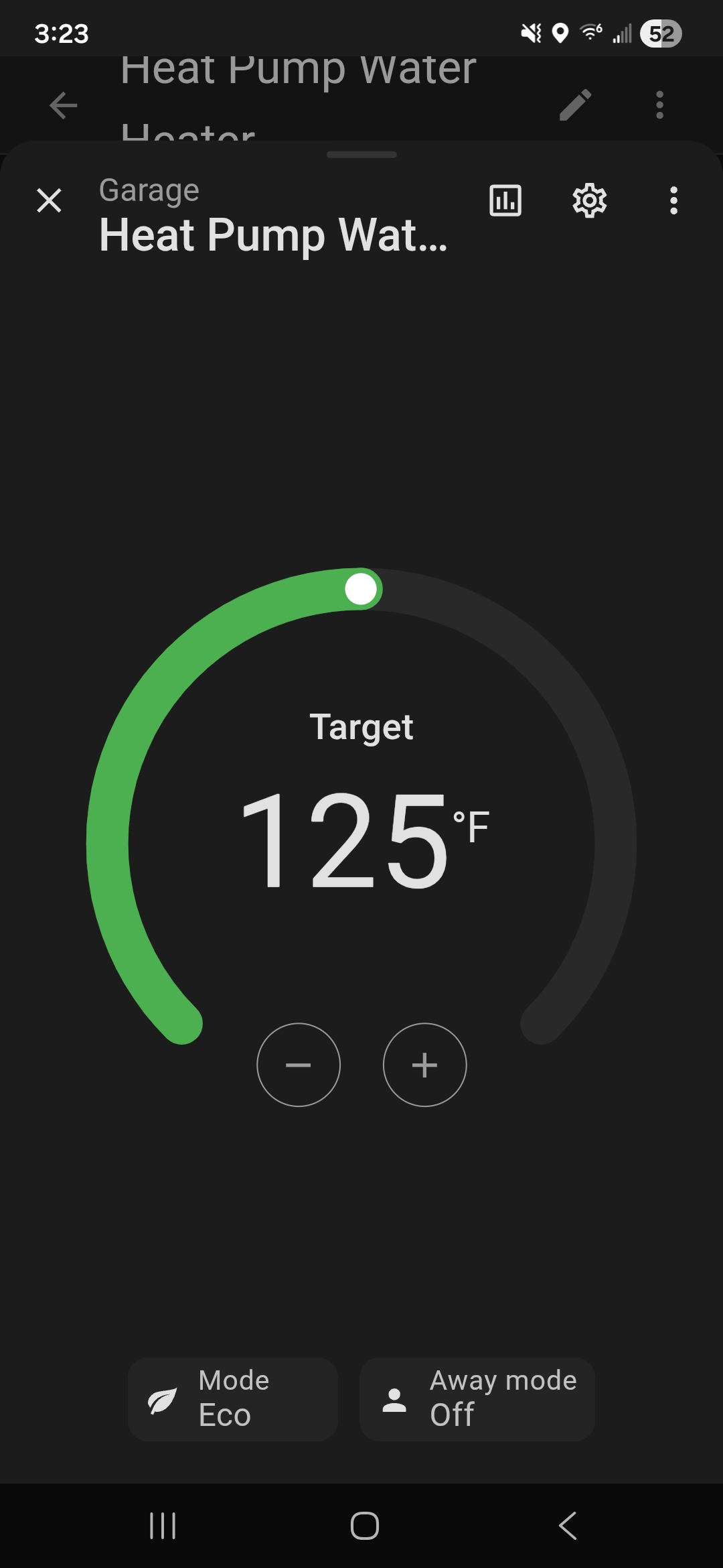

And now on how I’m managing it:
I’m currently running both integrations mentioned above in parallel, but I might ditch the native EcoNet one and keep the ESPHome-EcoNet one.
While the manufacturer’s solution provides some info, the ESPHome one shows much more of what I want to see, e.g.
Native EcoNet Integration:
ESPHome:
I also get real-time power figures (in W) from the ESPH version while the native integration only provides daily energy consumption (in kWh) - and the native consumption figures seem questionable at best.

This is the builtin

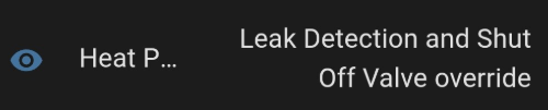

It seems like this sensor you’re showing
is the same as the Override Status on mine:
but mine doesn’t show any kind of state or has any attributes to derive any info from :frowning_face:
