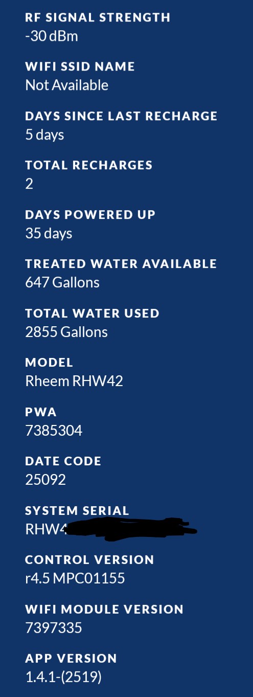

@jmacul2 Awesome!! The installation now goes without error, but I am not getting any settings/data besides the valve. For the serial, am I to use the dashes and the proceeding RHW####-#####-####?
The error in the logs is that the serial doesn’t exist
The serial is the not that. Its the same as the old app…and now I am realizing the new app doesn’t list it anywhere. Ugh! I guess we need to use the new one, but until I get that changed, you can find your actual serial number using the web app: iQua<device_id>/status
https://api.myiquaapp.com/v1/devices/<device_id>/detail-or-summary
Login via the web app, and capture the device_id in the url and then open the detail-or-summary api call. It will return json with a section called serial_number. The value in that is your actualy serial number.
The DSN number on that portal is the same RHW####-#####-####
I am an idiot and didn’t realize you were looking for the serialized link of the device.

It should start with SL and its 14 characters no dashes

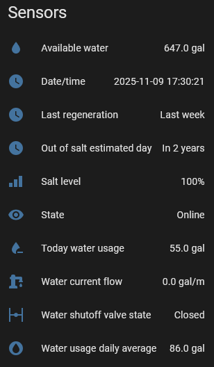

@jmacul2 Found it, wow nothing like the device serial on the softener itself.
YAY, the integration is now working and showing up.
The only issue I am coming across is that the times don’t match. Any way we can get UTC changed to the local timezone and change the field to data last update or something similar?
ok i made updates. you should be able to enter in the device serial number (old way) or the product serial number (in the new app) for setup.
dates and times should be fixed now.
Thanks for keeping this one alive.
I went ahead and deleted the one I had (briis) and added yours fresh. The Product Serial number wouldn’t work for me (just said it couldn’t connect to the server) but the device one did.
