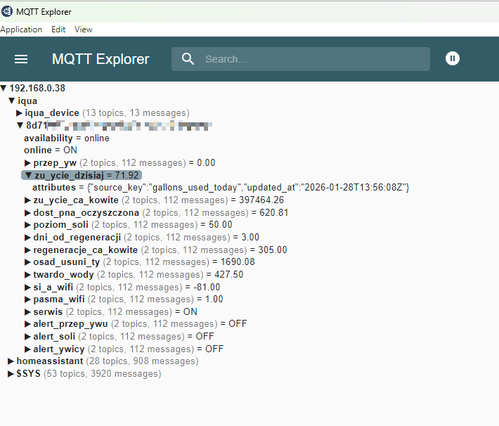

  1. Water Usage Today is given in m3, not in liters - I did Helper to recalculate this, but in the documentation it shows it in liters - some bug? Helper does not work properly - in the midnight drops negative values.

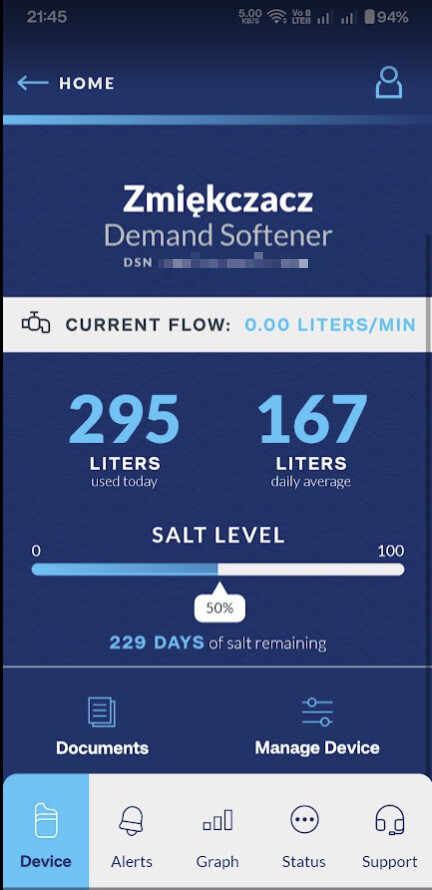

  2. Given today usage is very inaccurate - for instance I have 0.073 m3 used in the integration, but app iQua shows 295 l. Why so big difference?
  3. There is every 5 minutes log with time change - can this be turned off? It just overloading logs.

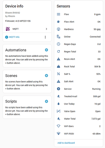

I also created a nice little Node-Red flow to pull data from this API - it converts it to MQTT messages so you can use discovery to bring them into Home Assistant. All you need is username and password for Iqua and it starts working.
Can you share how to do it or some code to deploy?
Here you go, import the following flow to Node-Red - [ { "id": "subflow_iqua_api_v2", "type": "subflow", - Pastebin.com
Enter your creds for iqua and mqtt server info and deploy
I deployed code, after a few changes it was working, but I cannot find anywhere entities, do the show up automatically or I need to create something manually?
++ how to turn off units conversion?
You will need to add the MQTT integration. A device will be created and entities will be under there.

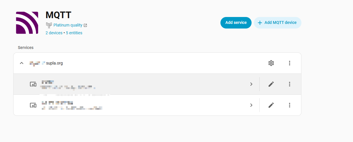

I cannot add another service - I already have one there - ideas?
Can you send me an example of a payload that is getting sent to your Mqtt node. Did you set that up and it is showing connected?
I put all in DM to You.
Values are in place
