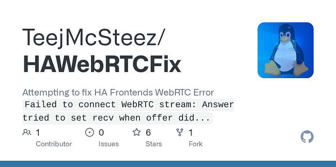

The Temp fix from here works well
Which files do we need to put into the new directories?
Great this worked!
So easiest way to do this is clone the git into custom_components/ring (make this directory and install all the files) When you’re done installing reboot the machine and viola! it should work like normal
