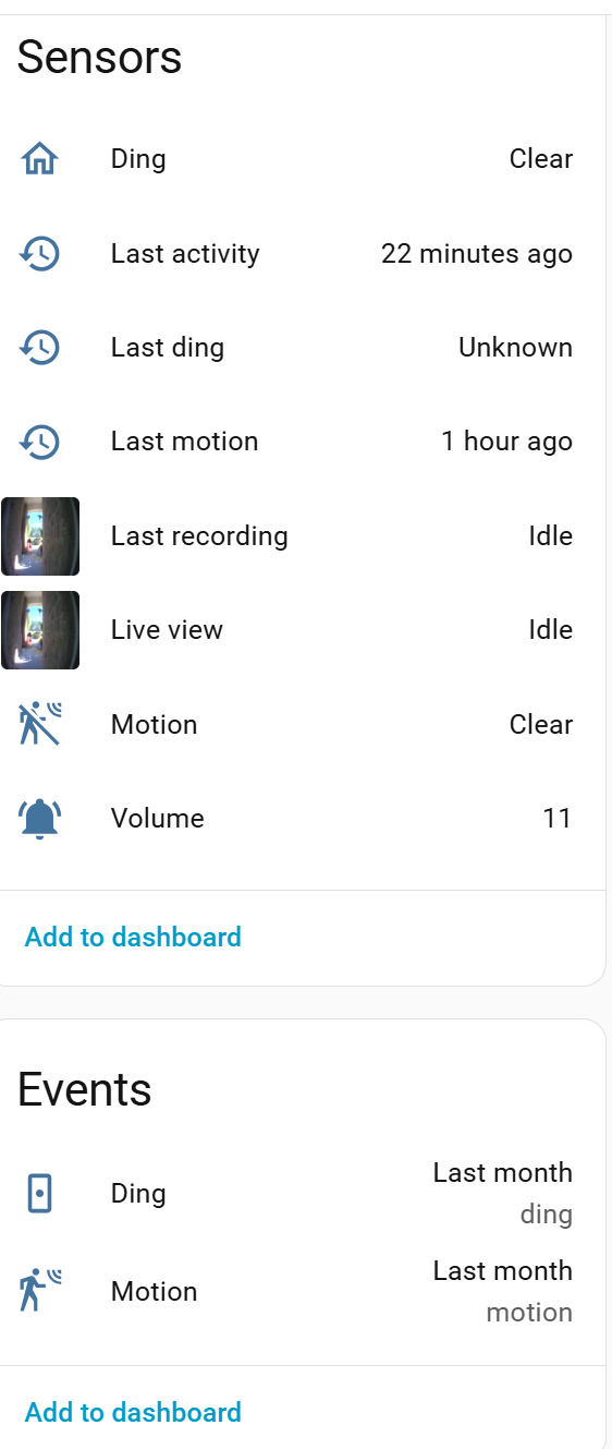

Here are the list of entities and events that I have available in my Ring Integration:
Does anyone know what new event entity was created to replace the binary_sensor.front_door_ding ?
The events are listed in the integration page for Ring integration.
