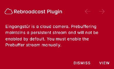

If you open live view in Ring does the stream come online? I thought it only produces a stream with motion is detected or its broadcasting through liveview from Ring app.
Yeah I think so too. How can I change this? In scrypted told me this:
But I cant change settings in scrypted. Strange …

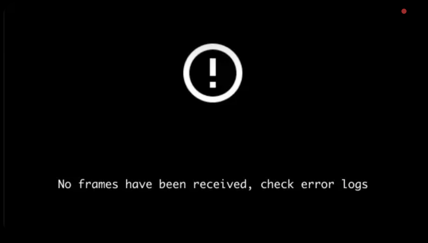

I can add the rtsp-link to the service “generic camera”. After adding the camera to “genereic camera” I can see the live-view including audio very fast in “generic camera”. But in frigate I cant see the live-view:
