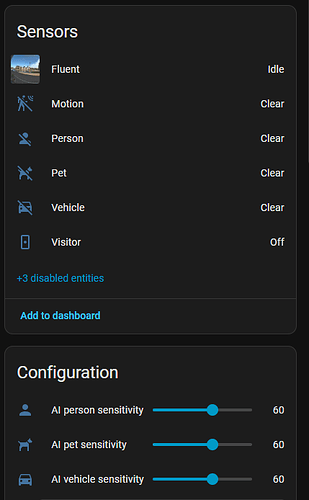

Reolink :smiley:
With a bit of effort, works from within HA too (using a webrtc card), making it work on IOS, Android, Windows, Linux and MacOS (using a browser) :wink:

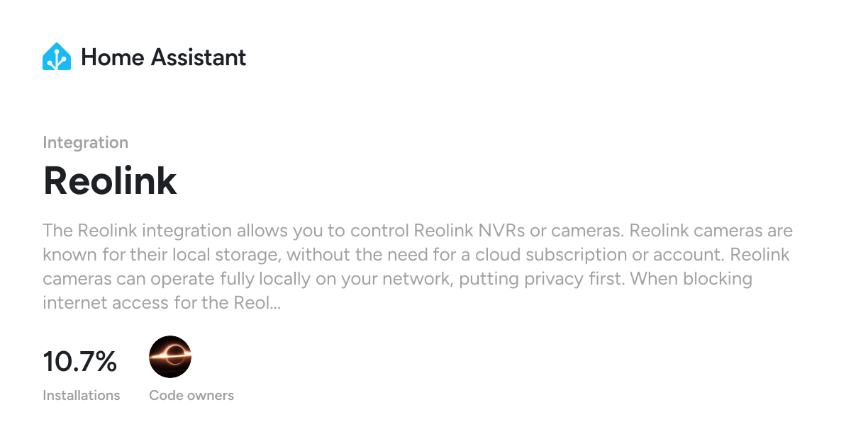

I myself use the ReoLink POE doorbells
Btw, ReoLink is 100% local and has platinum status :wink:

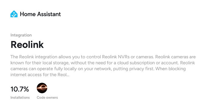

What i said…reolink
