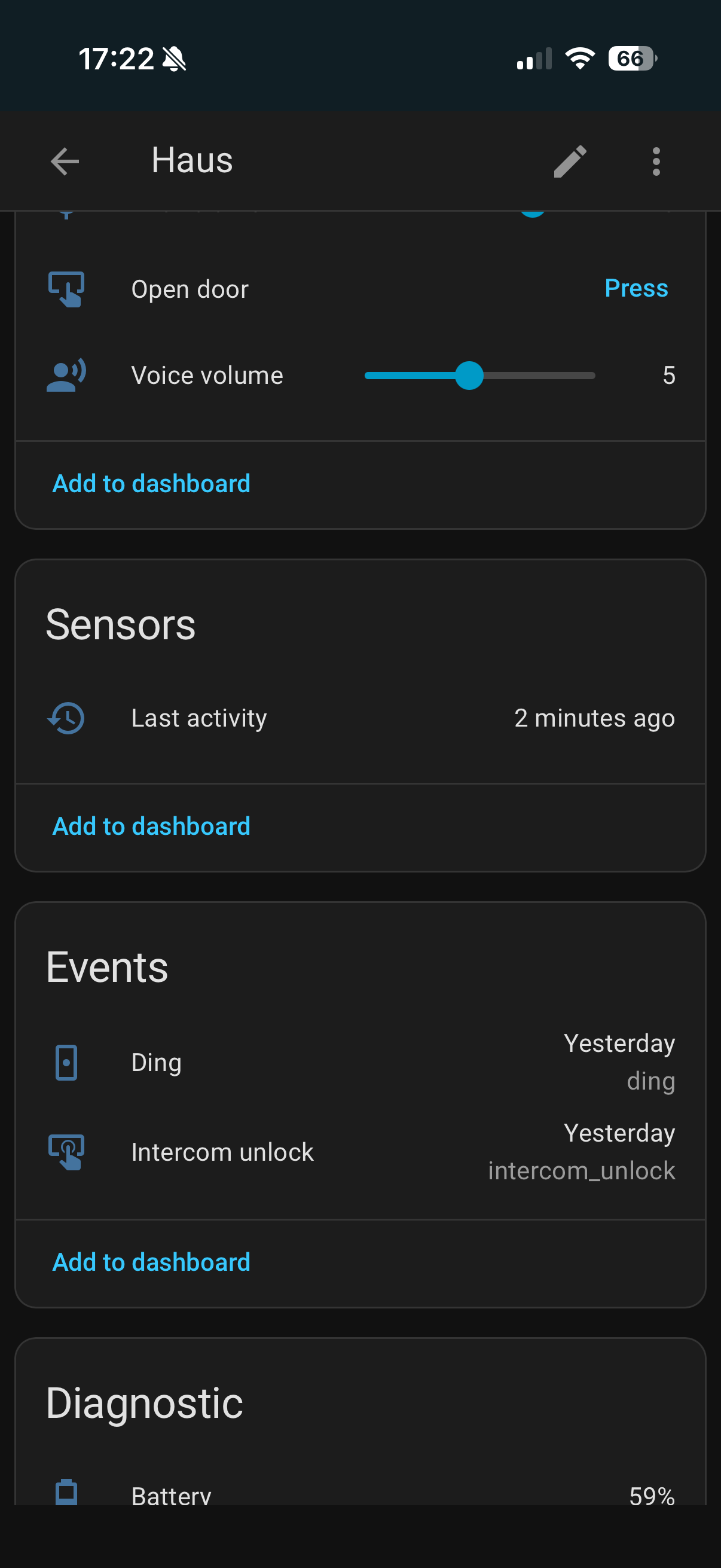

It will work for a day or two or just a couple of hours before failings. It’s not that the entire integration is losing access, just the ding part.
See attached screenshot.
