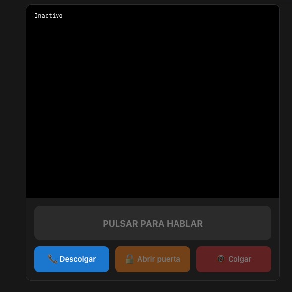

I've just released a Lovelace card that adds full UI support for the Ring Intercom Video device (the 2024/2025 model with built-in camera) in Home Assistant: live video, two-way audio with push-to-talk, open door, hang up.
:link: Repo: GitHub - cmos486/ring-intercom-video-card: 🛎️ Two-way audio & video card for Ring Intercom Video in Home Assistant. Native WebRTC, push-to-talk, open door, multi-language. HACS compatible. · GitHub
:link: HACS-compatible (custom repository for now, applying to default soon)
:thinking: What is this
A Lovelace card that gives a complete UI for answering and managing calls from your Ring Intercom Video directly from Home Assistant:
  • :video_camera: Live video stream from the intercom
  • :microphone: Two-way audio with push-to-talk button
  • :unlocked: Open door button (uses Ring's native lock or any custom service)
  • :no_mobile_phones: Hang up with full session teardown
  • :hammer_and_wrench: Visual editor with entity pickers — no YAML required
  • :globe_showing_europe_africa: Multi-language UI (:spain: Spanish, :united_kingdom: English, :spain: Catalan) with auto-detection
  • :electric_plug: Pure browser WebRTC — no go2rtc, no transcoding, no extra add-ons

:clapper_board: How to use it
  1. :bellhop_bell: Doorbell rings (or you decide to peek)
  2. :backhand_index_pointing_up: Click :telephone_receiver: Pick up
  3. :microphone: Allow microphone access (first time only)
  4. :television: Live video appears, push-to-talk button activates
  5. :speaking_head: Hold the green button to speak
  6. :unlocked: Open door or :no_mobile_phones: Hang up
