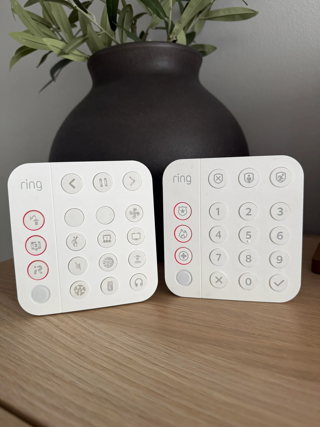

I had been using an old Ring keypad for basic automations in my home office. #1 would toggle the fan on/off, #6-#9 would toggle a certain music playlist, etc. It worked fine, but I wanted to have something in the living room that anyone could use.
Opening up the keypad without completely mangling the enclosure took some time, and separating each button from the membrane without ripping anything made my hands arthritic. The geometry of the buttons differed, so measuring, modeling, and 3D printing was a labor of love filled with trial and error (and frustration)
It’s not perfect and there are so many improvements to be done, but it’s functional. The buttons in red require to be held for a short moment, so I placed some automations there I would not want to “butt dial” For example, holding the button on top of the iRobot one announces my phones location. I have ESP32s hidden throughout the house running Bermuda so when it’s toggled, my Sonos speaker announces the location, waits 3-4 seconds, then audibly pings my phone.
Why are the previous, pause, and next buttons on the top row? With the exception of the “X” and "✓" buttons, #s 0-9 have a short delay. The top row (formerly disarmed, home, and away mode) fire instantly making it perfect for this use case.

  • Elegoo Matte White PLA
  • Overture translucent PETG
  • 0.2mm nozzles (I know it’s not recommended for translucent PETG but I had no choice. Zero issues though)
  • Patience
