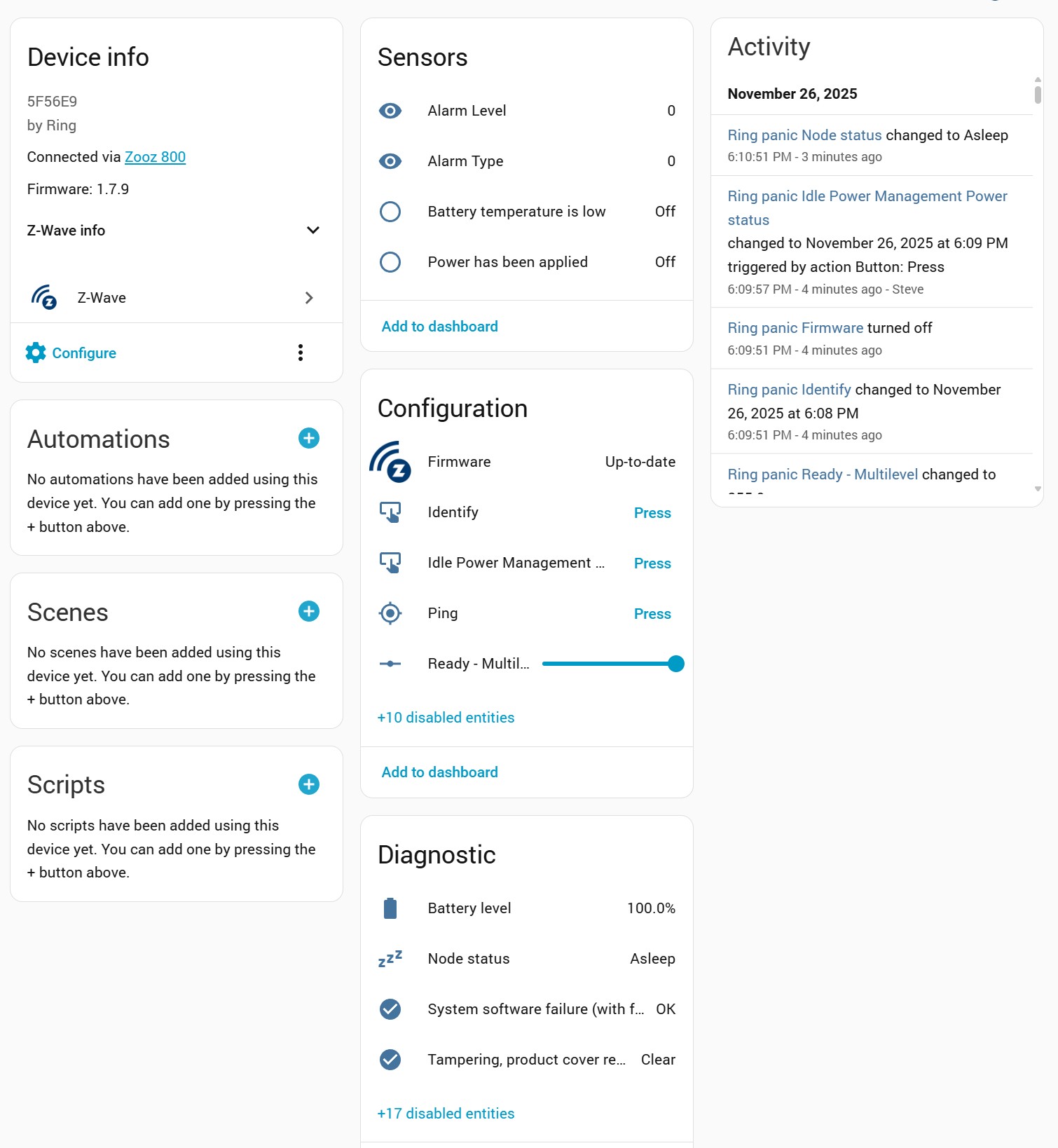

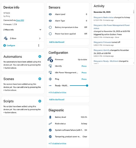

Ring Panic Button-- where is the button press?
It adds via Z-wave JS just fine, all the entities show up. But where is the “button press” which is the entire function of the panic button? Nothing happens in the activity list when I push the button. The hidden reset button wakes the node up but that’s it…
Won’t the button press be an event? In an automation you can either trigger on the timestamp, or use a device trigger.
Nope I don’t get any event response on button press. That’s what’s confusing, the device is supported in Z-Wave JS Config DB Browser
but there is NO entity to expose a button press.
The only buttons are: identify, ping and power status. None react to button press.
