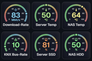

Do you have any solution how to show the unit in a consistent style?
In some cases it’s shown below the value, in some cases right of the value, but these cases I have avoided and used the “%” icon on top as unit.
Here are the tweaks I’m using at the moment.
colorize_icon: true
tweaks:
  rt-background-text-opacity: 1
  rt-scale-text-opacity: 1
card_mod:
  style:
    rt-ring-svg $: |
      text.middle  {
        color: var(--rt-indicated-color);
For some minor cosmetics like making the ticks more visible and the number a little bit smaller I’m still testing all the provided CSS variables and the card_mod possibilities.
@neponn Love Ring Tile. Spent last day converting dashboards!
I have three atmospheric pressure sensors. None of the sensors are recognised by Ring Tile to create the standard atmosphere layout. Device class of all is Atmospheric_Pressure and unit hPa. Using latest Ring Tile version
Something not working? Or is it me?
Edit 3: anyone using dynamic icons to reflect pressure state? Template?
Hi again @scw2wi - looking good! You’re not the first to ask for more control over units that currently stay inline (#44). It’s on my list.
In the meantime, you can get the result you want with a bit of a hack.

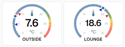

I got all excited when i decided to try and incorporate the the custom:card-templater, because as I was bulding it the configuration card showed exactty what I wanted to achieve.
My code:
type: custom:card-templater
entities:
  - sensor.th_maxs_mins
card:
  type: custom:ring-tile
  entity: sensor.outside_climate_temperature
  ring_entity: sensor.outside_climate_temperature
  ring_size: 3
  colorize_icon: true
  middle_element: ring_value_with_unit
  bottom_element: name
  indicator_color: red
  max: 30
  min: 0
  marker_color: blue
  marker2_color: red
  marker_with_unit: top_element
  scale: ticks_with_labels
  marker_template: "{{ state_attr(\"sensor.th_maxs_mins\", \"out_temp_min\")}}"
  marker2_template: "{{ state_attr(\"sensor.th_maxs_mins\", \"out_temp_max\")}}"
Sadly it doesn’t display in the dashboard.
I wonder, is there any future plan to allow this?
Hi @Lordlinhey - glad you like it!
If I’ve understood what you are trying to do, you should find that your use case is already supported without custom:card-templater (with which I don’t have any experience). markers can be configured to reference the attribute of an entity (as can min and max as well). See the docs on configuration options and referencing entities and attributes.
Try the following (also a few suggested corrections):
#ring_entity: sensor.outside_climate_temperature   # this isn't needed because it is the same entity
ring_size: 3
colorize_icon: true   # this will be ignored because your config does not include an icon
top_element: marker   # this was back to front; I suggest not including _with_unit
middle_element: value_with_unit    # ring_ isn't needed - your ring_entity and entity are the same
#indicator_color: red   # this is not a supported option
max: 30
min: 0
marker_color: ha_blue   # you might like to try ha_* colours for consistency with HA
marker2_color: ha_red
marker:
  entity: sensor.th_maxs_mins
  attribute: out_temp_min
marker2:
  attribute: out_temp_max
Let me know whether this addresses your needs.
