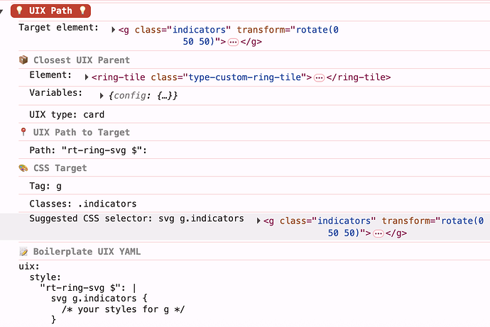

Version 5.3.0 of UIX just released. 5.3.0 now how DOM inspection helpers so you can get assistance in how to set your UIX selectors.
e.g. without much fuss, I looked for the dot of the ring-tile-card, then used uix_path($0) to get the following…
Then easily added my CSS to get a pulsing indicator dot - which could be extended with a template to pulse only when on a certain value condition.
uix:
  style:
    rt-ring-svg $: |
      svg g.indicators {
        animation: pulse 1s infinite;
      @keyframes pulse {
        0% { opacity: 1; }
        50% { opacity: 0.5; }
        100% { opacity: 1; }

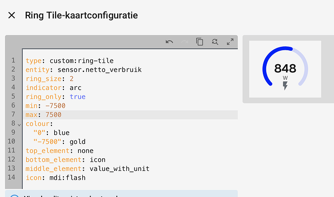

this must be too simple… however, I need some help :wink:
type: custom:ring-tile
entity: sensor.netto_verbruik
ring_size: 2
indicator: arc
ring_only: true
min: -7500
max: 7500
colour:
  "0": blue
  "-7500": gold
top_element: none
bottom_element: icon
middle_element: value_with_unit
icon: mdi:flash
shows like

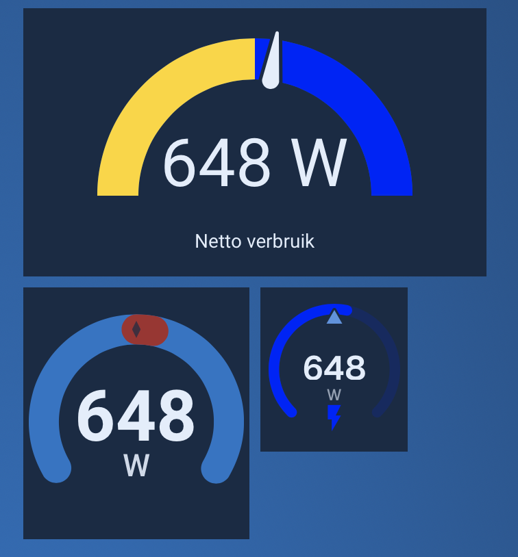

while Id like the indicator to start from the 0 position top center going either clockwise - positive (consumption) or counter-clockwise - negative (production) of (solar) energy
like this:
How can I set options to do so?
also, I 'hacked my way into the elements, because there is no single ‘unit’ option for the middle element.
btw setting a marker at 0 shows that is correct at the top center, so the colorization is not correct?
maybe a FR would be in place?
Hi @Mariusthvdb - that’s a cool use case - good idea. Unfortunately, I can’t think of a way to do that with the current implementation, so it will have to be a feature. Maybe something like indicator: arc_from_zero or similar. I’ll give it some thought.
On your second question - I’m not quite sure I understand. What hacking did you need to do (and why) and what were you expecting in terms of colourisation? Looking at your grad definition, for a value of 755 W, I would expect the icon to be coloured blue, which it is?
that was in regards to the elements I seek to be shown. I want expecting the W t be shown as singled out unit, and as part of the state, hence I set that to none
as for the color there, Id expect the color on the 755, not start in the left side, but start from the top middle section, and yes then be blue. just like the 829 gauge being brown there. the essential bit is the starting point. It should either go left, or go right, and always from the top center.
added a screenshot with stock gauge now also, which I hope makes clear what I am after (concerning the colors, not the rest of the design obviously)
