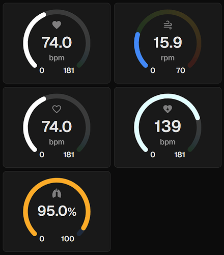

- type: custom:ring-tile
            entity: sensor.whoop_andrew_resting_heart_rate
            ring_size: 3
            min: 0
            max: sensor.whoop_andrew_max_heart_rate
            color:
              '118': white
              '140': lightcyan
              '151': skyblue
              '161': limegreen
              '172': orange
              '200': orangered
            entity: sensor.whoop_andrew_sleep_respiratory_rate
            ring_size: 3
            min: 0
            max: 70
            color:
              '11.9': gray
              '16': dodgerblue
              '20': limegreen
              '30': yellowgreen
              '40': gold
              '50': orange
              '60': red
            entity: sensor.whoop_andrew_day_average_heart_rate
            ring_size: 3
            min: 0
            color:
              '118': white
              '140': lightcyan
              '151': skyblue
              '161': limegreen
              '172': orange
              '200': orangered
            entity: sensor.whoop_andrew_day_max_heart_rate
            ring_size: 3
            min: 0
            color:
              '118': white
              '140': lightcyan
              '151': skyblue
              '161': limegreen
              '172': orange
              '200': orangered
            entity: sensor.whoop_andrew_spo2
            ring_size: 3
            min: 0
            max: 100
            color:
              '90': dodgerblue
              '95': orange
              '100': limegreen

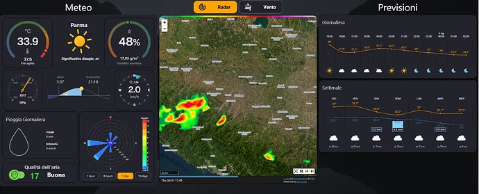

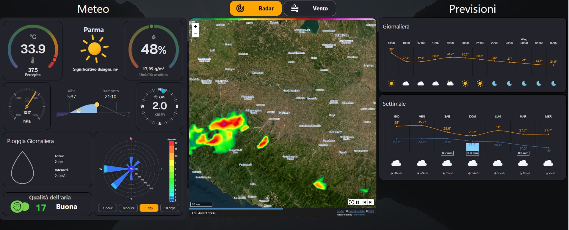

Many thanks Nick. I saw this great card and redesigned my weather dashboard. And this is the result:
Looks amazing! Thanks for sharing!

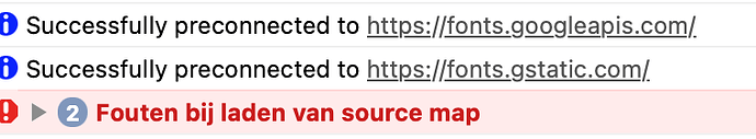

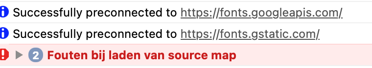

Hi Nick,
next that earlier mentioned (and raised) issue of the source map, I now also notice that there are 2 external connections made when loading this resource:
tbh, I am not sure what that exactly means, but Ive never seen something like that before in my custom cards, and not a big fan of loading external stuff. Let alone from G…
is this something that can be avoided?
