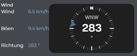

First of all, THANKS for this great card. I already replaced a lot of former elements to this card. The only missing is “Compass”. I’m currently using the custom:compass-card, which gives me an option to make color-coding based on windspeed. Is there an option in your card to achieve the same? I would like to have a color change of angle based on windspeed. This is my actual config:
type: custom:ring-tile
entity: sensor.xxx_windgeschwindigkeit
marker: sensor.xxx_windrichtung
ring_type: compass_n
ring_size: 2
ring_only: true
marker_colour: var(--my-blue)
max_decimals: 0
Is there a way to change the font size of the middle element?
Hi @somansch - great that you like it!
compass-card provides many more options that ring-tile card - I don’t intend to go to the same level of customisability. Right now, there are no built in ways to change colour based on windspeed, although it would be possible to hack something together with card_mod.
Out of curiosity, what element would you like to colour with respect to windspeed?

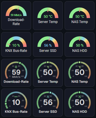

I am redesigning my monitoring from gauge-card-pro to ring-tile,
and it already looks much better, not only because of the ticks_with_labels.
