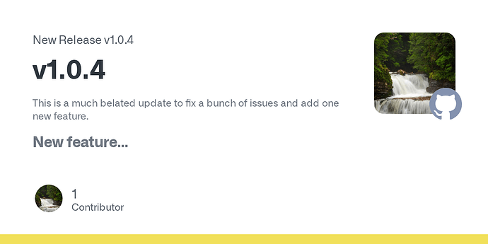

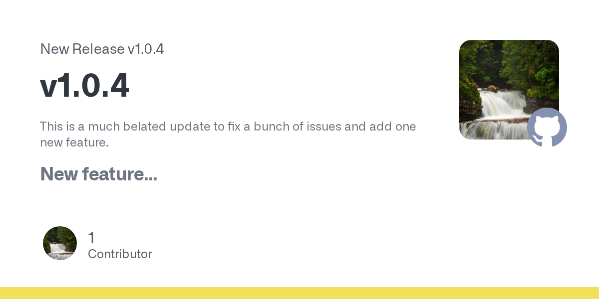

New release v1.0.4
At long last, time for an update. Thank you all for your patience - this update took much longer than I ever expected. Turns out maintaining an open source project (even a small one) isn’t as easy as it looks… :wink:
This release is mainly bug fixes, but one new feature as well.
With this round of bugs out of the way, I’m hoping to hit a few features next.
New feature
Bug fixes
  • Prevent min / max values tangling by reducing decimal points if required (#30)
  • Localise decimal point (comma or full stop) (#33)
  • Fix bottom_element: ring_value (#35)
  • Treat empty attribute values as zero (fixes light off case described by @scw2wi) (#41)
  • Fix grad colour scaling for proper alignment between indicator and grad colouring (#42)
  • Improve card_mod handling - this should help with setting CSS variables when ring-tile is part of a stack. For example @scw2wi’s problem and @mynolix1986’s case. Thanks @dcapslock for the tip on how to fix (#12 sub issue)
  • Render icons as pure SVG to improve scaling when customised sizing is applied. Should help improve the look of the case @swampylee described (#6)
  • Reduce icon size for larger rings when used as bottom_element
