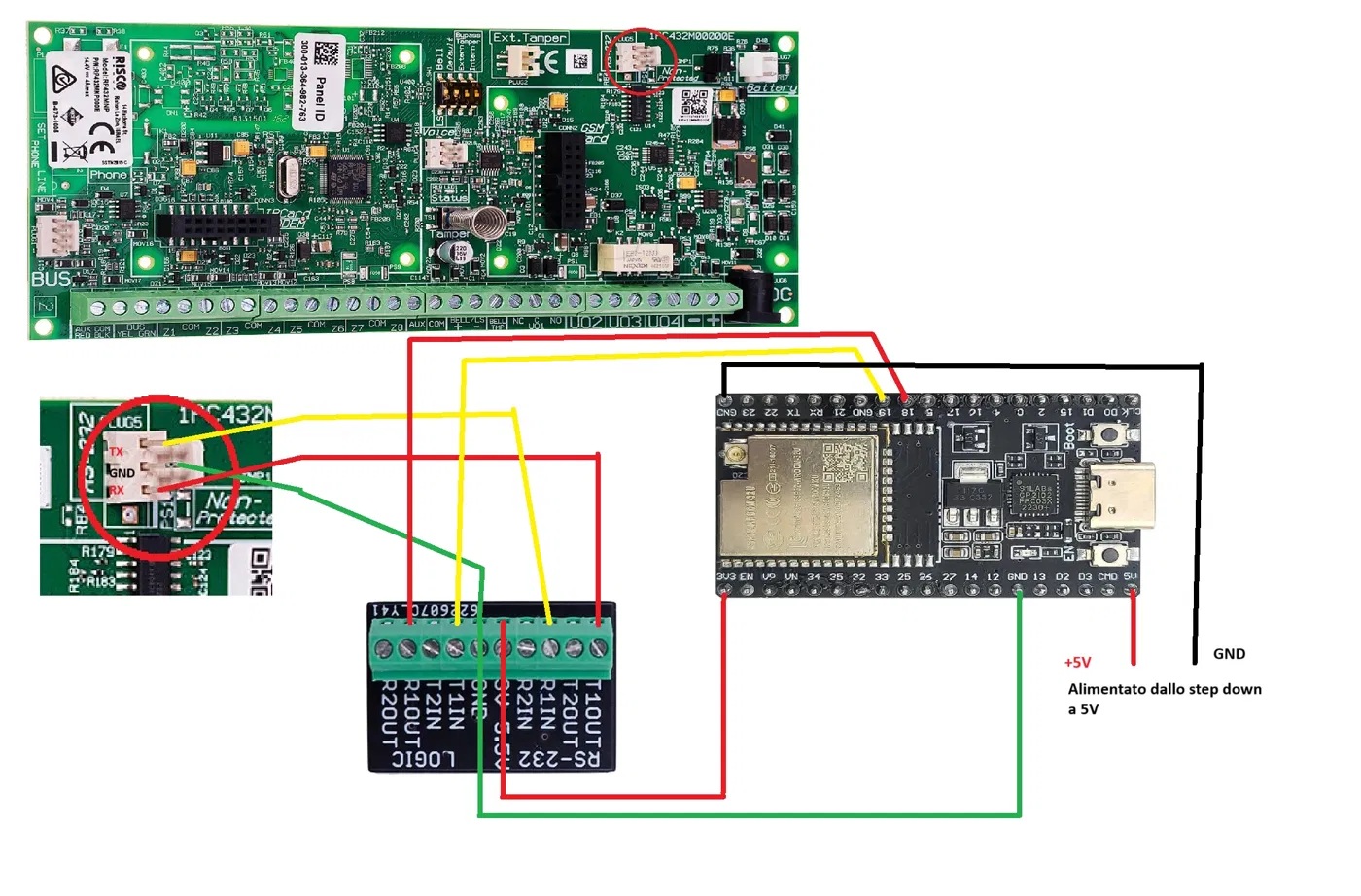

Has anyone got a link to the latest Confguration Software. Mine has stopped working unfortunatly. Still running 3.1.0.1 :stuck_out_tongue:
To start, since this is an early Risco LightSYS model, I only have the GSM module installed, and the control panel firmware is stuck at version 1.46. Lacking an IP module and tired of using SMS, I decided to see if there was a way to integrate it into Home Assistant. I’m currently experimenting with an ESP32—connecting it to the panel’s “Plug 5” (just as one would with the configuration software) and trying to use Risco MQTT Local—but I haven’t managed to get it working yet. I am using the HA Add-on version 2026.1.5-beta2.

9/12/2026, 3:53:25 PM [verbose] [RLB] Command[1] Sending Command: RMT=5678
9/12/2026, 3:53:25 PM [debug] [RLB] Command[1] Writing command buffer to socket: [2,48,49,82,77,84,61,53,54,55,56,23,66,48,70,56,3]
9/12/2026, 3:53:25 PM [debug] [RLB] Command[1] Data Sent : RMT=5678
9/12/2026, 3:53:30 PM [warn] [RLB] Command[1] ‘RMT=5678’ Timeout
9/12/2026, 3:53:30 PM [debug] [RLB] Command[1] command response : undefined
9/12/2026, 3:53:30 PM [error] [RLB] Risco command error: TIMEOUT. Command: {“panelId”:1,“commandId”:1,“attempts”:4,“crcOk”:false,“commandStr”:“RMT=5678”,“sentBuffer”:{“type”:“Buffer”,“data”:[2,48,49,82,77,84,61,53,54,55,56,23,66,48,70,56,3]}}
9/12/2026, 3:53:30 PM [verbose] [RLB] Command[2] Sending Command: DCN
9/12/2026, 3:53:30 PM [debug] [RLB] Command[2] Writing command buffer to socket: [2,48,50,68,67,78,23,65,53,65,67,3]
9/12/2026, 3:53:30 PM [debug] [RLB] Command[2] Data Sent : DCN
9/12/2026, 3:53:35 PM [warn] [RLB] Command[2] ‘DCN’ Timeout
9/12/2026, 3:53:35 PM [debug] [RLB] Command[2] command response : undefined
9/12/2026, 3:53:35 PM [warn] [RLB] Risco command error: TIMEOUT. Command: {“panelId”:1,“commandId”:2,“attempts”:1,“crcOk”:false,“commandStr”:“DCN”,“sentBuffer”:{“type”:“Buffer”,“data”:[2,48,50,68,67,78,23,65,53,65,67,3]}}
9/12/2026, 3:53:35 PM [warn] [RLB] Error while sending DCN command
9/12/2026, 3:53:35 PM [debug] [RLB] Socket Destroyed.
9/12/2026, 3:53:35 PM [info] [RLB] TCP Socket Disconnected
9/12/2026, 3:53:35 PM [info] [RLB] Automatic reconnection will be attempted in 10000 ms
9/12/2026, 3:53:35 PM [debug] [RLB] Socket Disconnected.
I’m doing all this using an ESP32 with an onboard stream server: github://tube0013/esphome-stream-server-v2
Can anyone help me with this?
