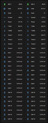

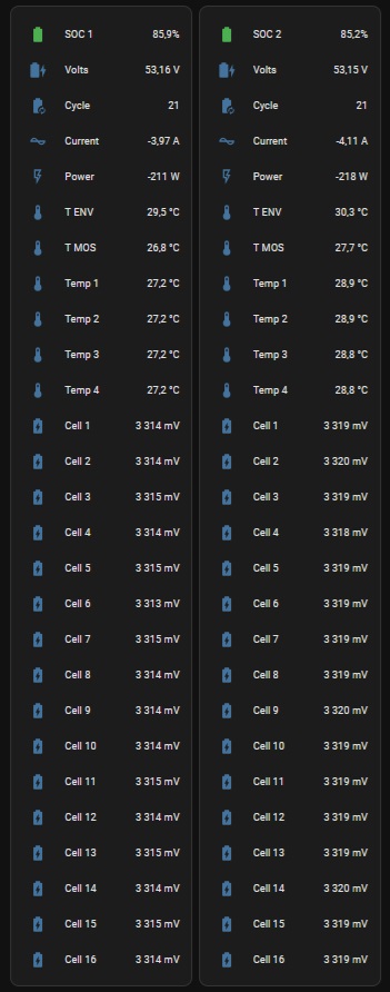

screenshots :

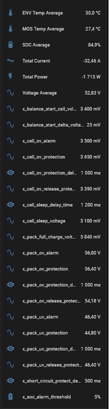

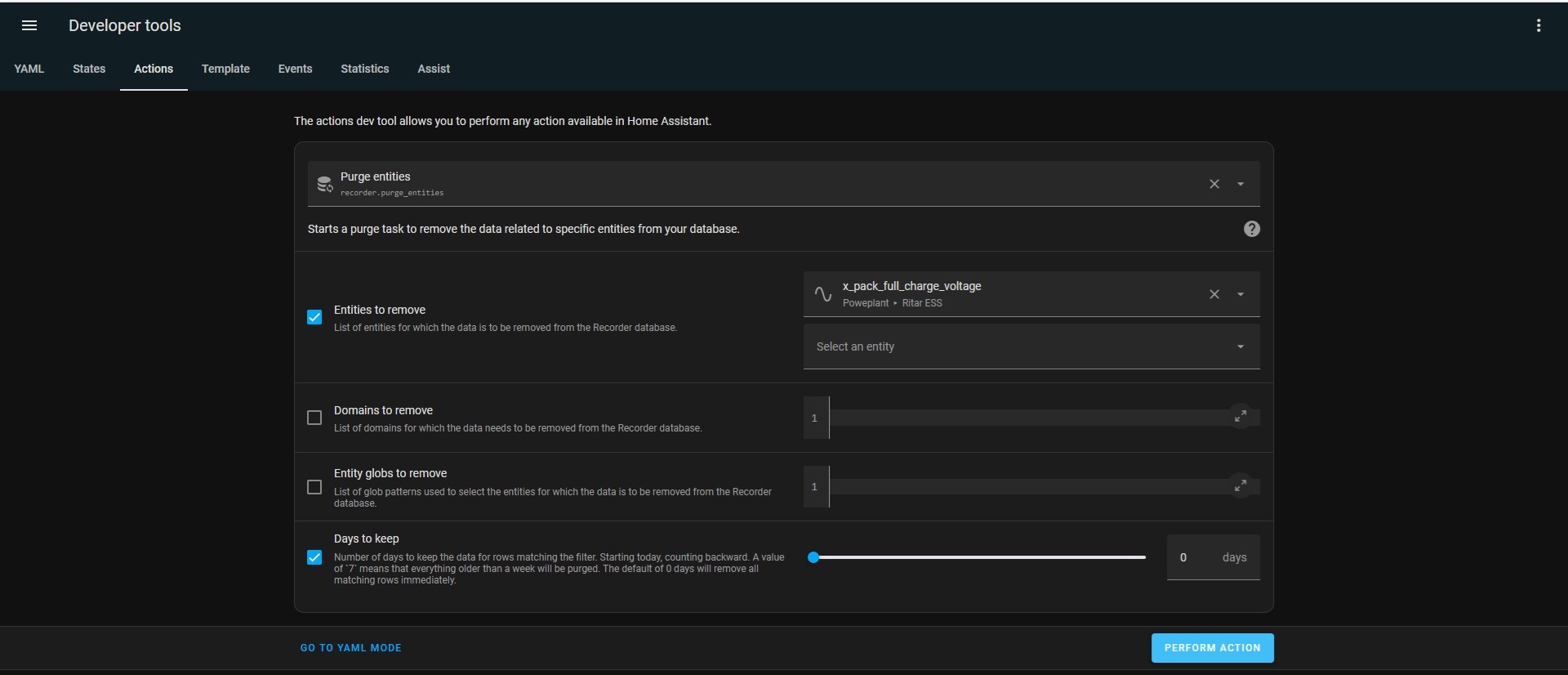

Known issue - x_pack_full_charge_voltage - displayed to mqtt as mV (5840), but must be showed in V like 58.40. Will be fixed in close 1-2 days.
UPDATE 1.9.4.1 - HOTFIX Fixed wrong measurement unit for x_pack_full_charge_voltage. Please delete mqtt logic device “Ritar ESS”, and restart addon. It will repair wrong graphs. AND/OR delete entity missvalues graphs - HOWTO

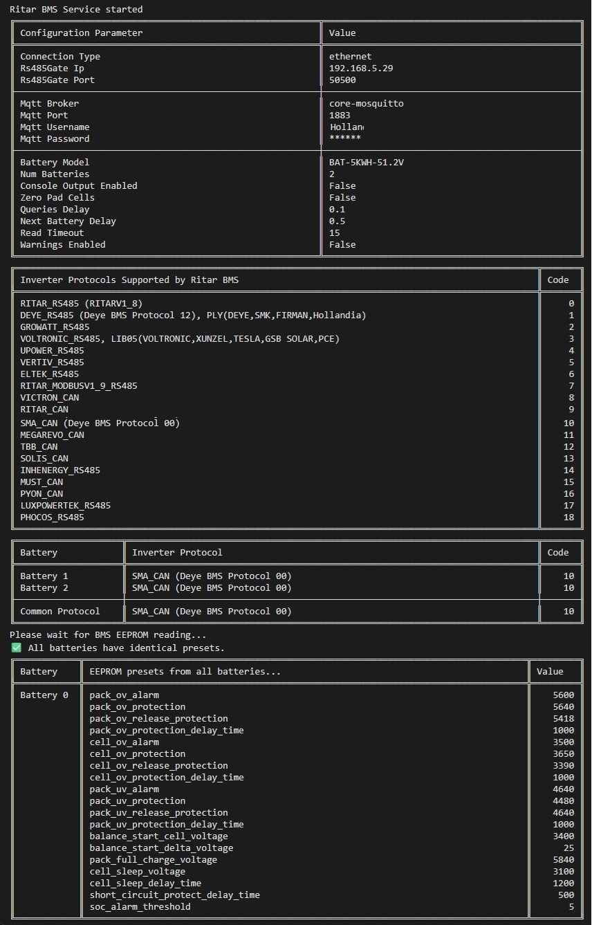

  • Introduced a built-in interactive debugger for the United BMS framework, accessible via SSH inside the container - READ MORE
      This update lays the foundation for more powerful diagnostics and development tools in future releases.

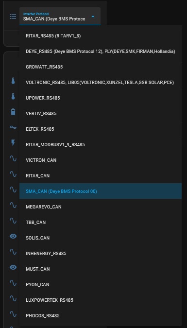

:hammer_and_wrench: Compatible Inverter Protocols
This addon supports setting inverter protocols via Home Assistant UI:
Code Protocol
0 RITAR_RS485 (RITARV1_8)
1 DEYE_RS485 (Deye BMS Protocol 12), PLY(DEYE,SMK,FIRMAN,Hollandia)
2 GROWATT_RS485
3 VOLTRONIC_RS485, LIB05(VOLTRONIC,XUNZEL,TESLA,GSB SOLAR,PCE)
4 UPOWER_RS485
5 VERTIV_RS485
6 ELTEK_RS485
7 RITAR_MODBUSV1_9_RS485
8 VICTRON_CAN
9 RITAR_CAN
10 SMA_CAN (Deye Protocol 00)
11 MEGAREVO_CAN
12 TBB_CAN
13 SOLIS_CAN
14 INHENERGY_RS485
15 MUST_CAN
16 PYON_CAN
17 LUXPOWERTEK_RS485
18 PHOCOS_RS485
