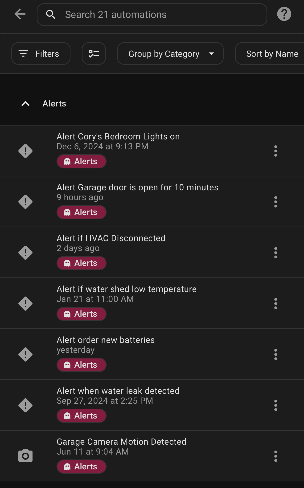

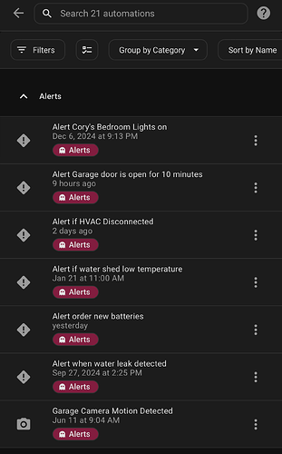

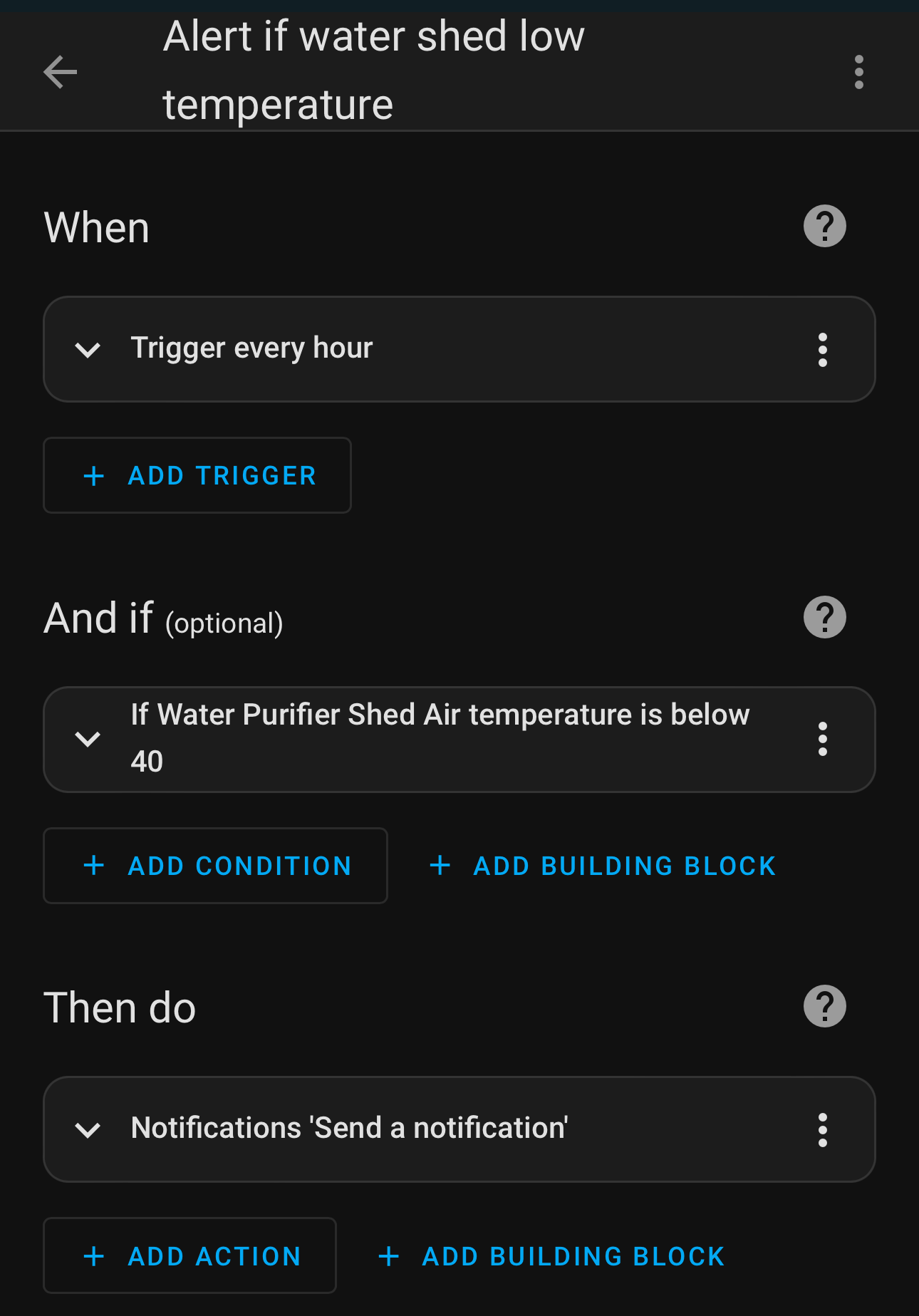

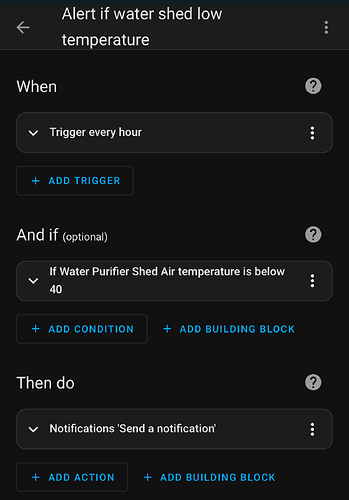

I do notifications via automations. I can share an example
This was counter intuitive at first because if you want continuous notifications and monitoring you need to set a periodic timer as the trigger and a condition to check.
You could most likely reduce these automations into a single one.
Not easily if you wanted detailed notifications I think. The logic would get messy pretty quick as the number of triggers and conditional blocks grows. It would likely reach a point where it would be a challenge to relate between triggers and notifications.
One automation per notification type keeps it all grouped and organized. Automations do not appear to create additional load as they are just listeners on an even loop from what I can tell (I have not reviewed the automation source so this is an assumption).
Automations can be grouped and I added the “Alerts” label for aesthetic purposes. It makes it really obvious that its only purpose is to notify.
Thanks for your example. I am doing notifications, as well. Actually I think most peoble do. The topic is about the complexity of the notifications across different platforms.
