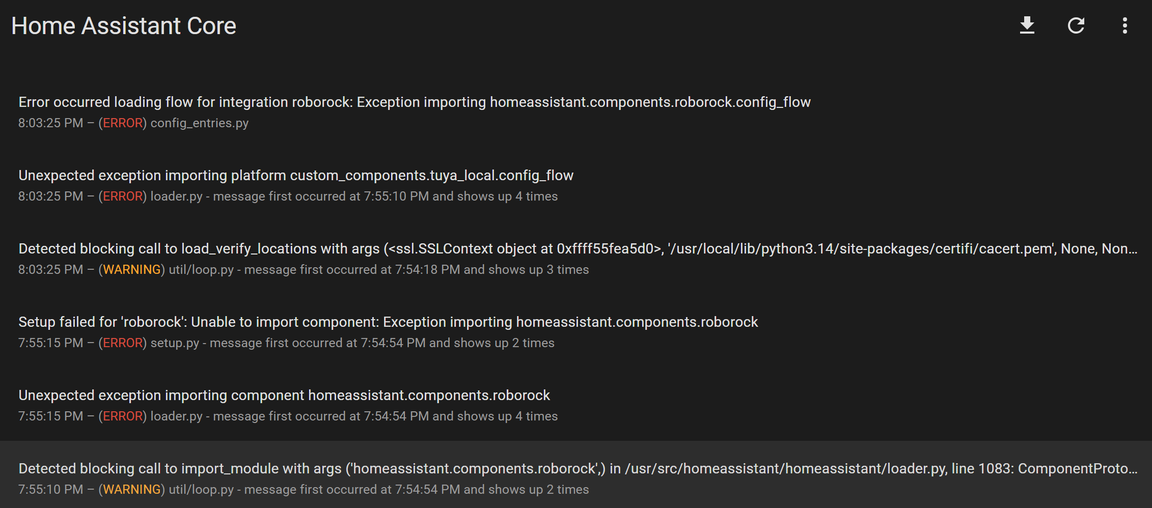

Roborock integration, errors after 2026.3.1
Roborock integration throwing errors after update to HA version 2026.3.1
Roborock integration is
One of the Roborock errors shows this:

I see DNS connectivity mentioned in the log. Any network issues?
